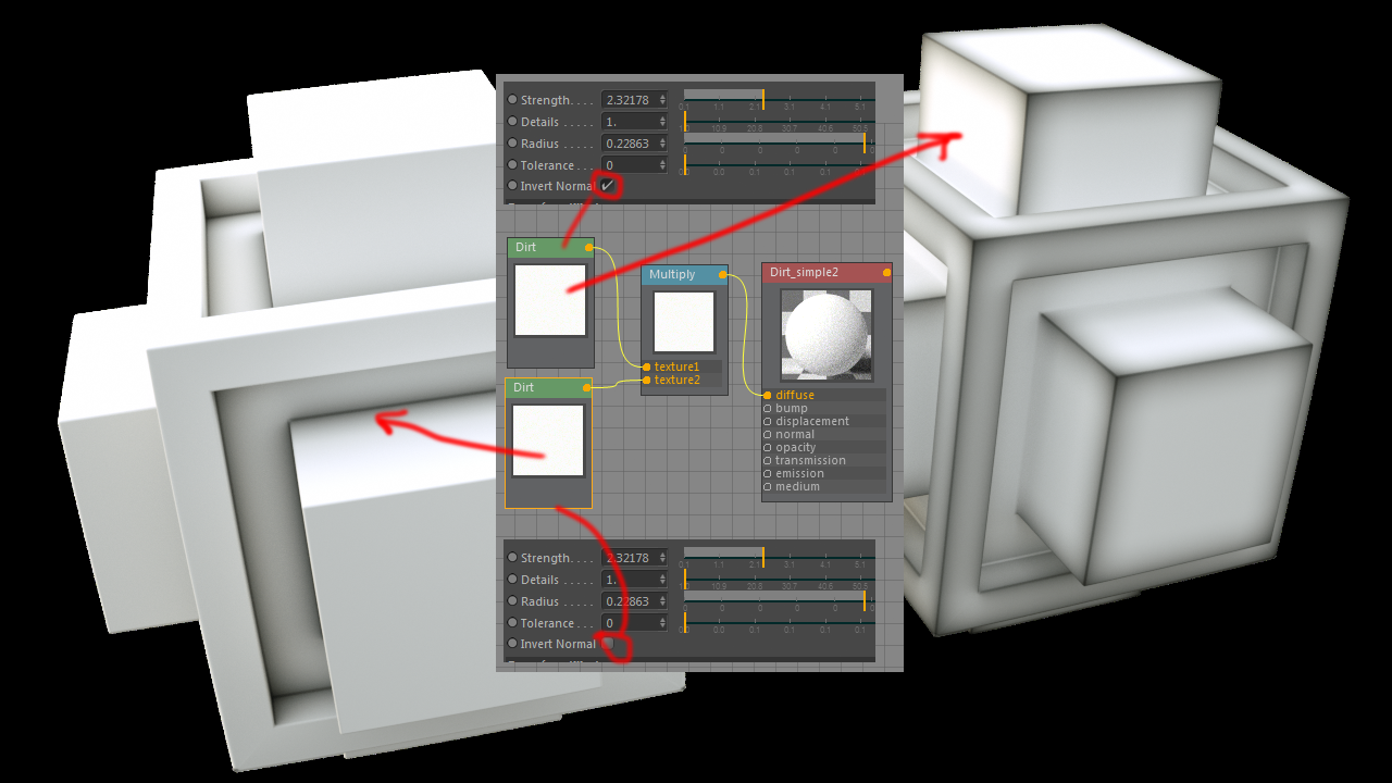

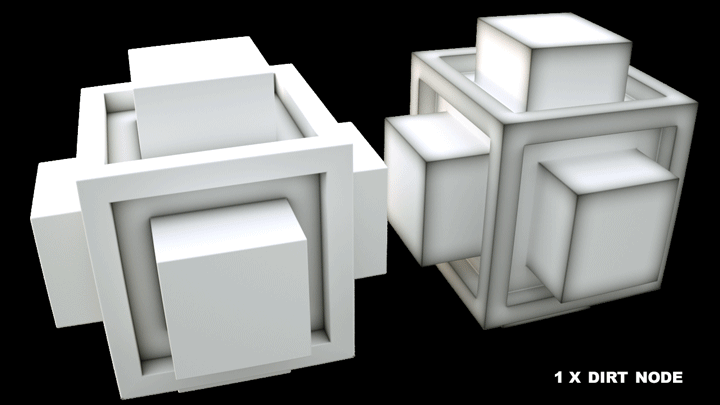

@blastframe :in addition to your nices procedural materials, i notice that dirt shader loose some edges to "dirtify" with object little bit more complex.it's due to the shader itself and normals matter , i presume
Therefore each should I use the dirt shader with objects having concavity, I double the dirt shader node in a multiply node, not forgetting to check or uncheck the "invert normals" box.
im not sure im clear
Here are the results in images with a simple and double node shader...
ciao

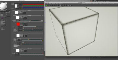

I'm trying to test the dirt shader and there is something I don't understand by following your steps.
For some reason, I can't put the turbulence in the dirt map…like you show at the beginning in your great tutorial.
I'm using the last version (2.12.2) of octane for c4d on Mac.
I've attached the cube test scene, is it coming from my octane version or did I really miss something?
Regis

you can use mix or multiply node to combine a dirt and turbulence. Also check new noise node. it's much better than turbulence

Thank you Ahmed, always here for us ;o)
Cheers

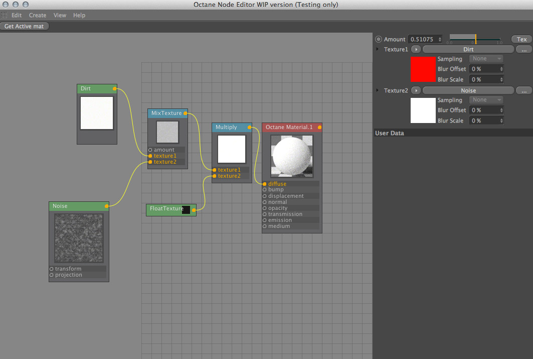

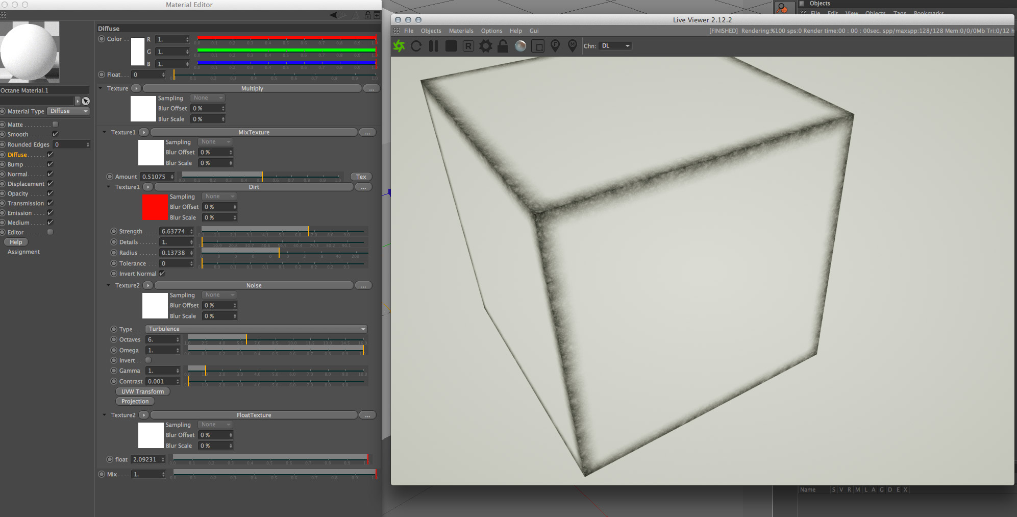

aoktar wrote:you can use mix or multiply node to combine a dirt and turbulence. Also check new noise node. it's much better than turbulence
Based on the advice of Ahmed, I found out this method, see attached screenshots.
Hopefully it might help someone ;o)
Cheers
Regis

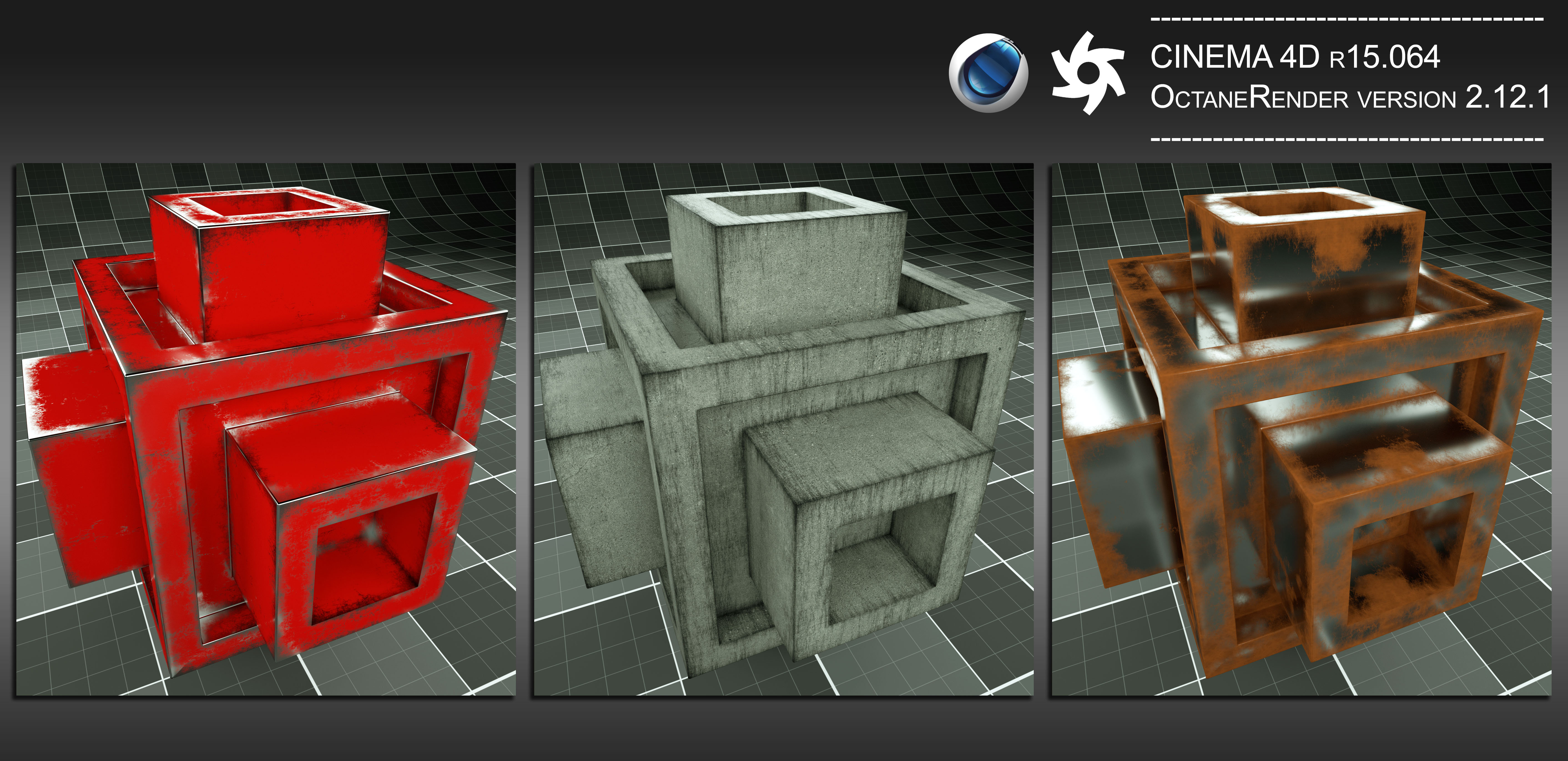

I also tried to reproduce this Blastframes tutorial and heres the result:
This is not exactly the same result but I link the file if it helps
http://we.tl/HrUc8CQGl3
ciao
