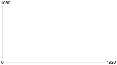

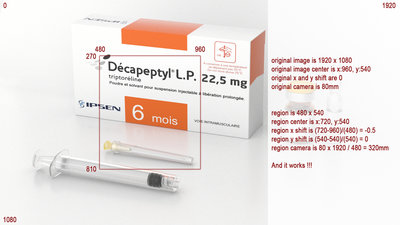

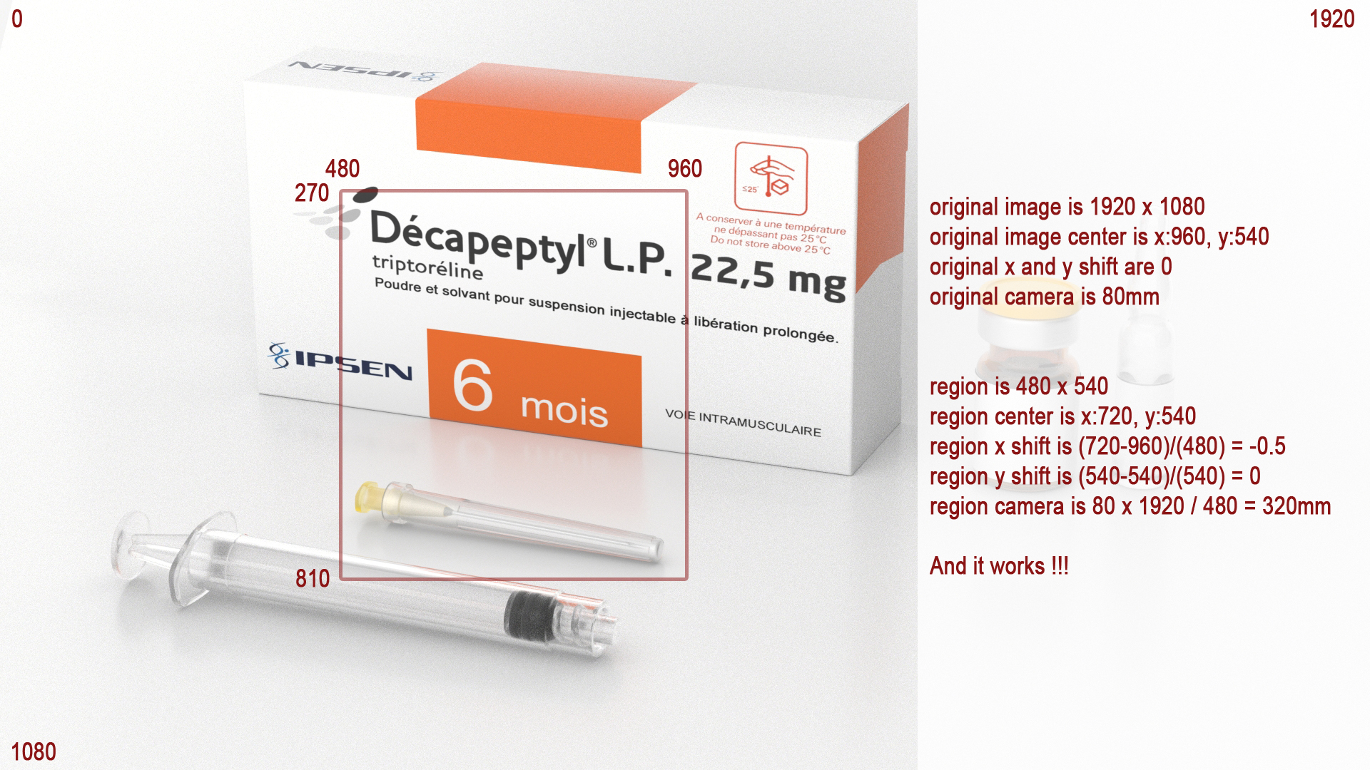

Hi Karba
I can't understand why region render is so difficult to implement :?:
1 - select a region on the screen, a simple rectangle will do the job.
2 - calculate new region dimensions and center.
3 - calculate new Lens = original Lens * original width / region width
4a - calculate x shift = (region x center - original x center) / region width
4b - calculate y shift = (region y center - original y center) / region height
5 - render the region in the right place of the frame buffer
See image below ...
I think a simple script could do the job in 3dsmax : scripters are welcome.
NB : a good think would be to take in account the original x and y shift.
that's all folks :D

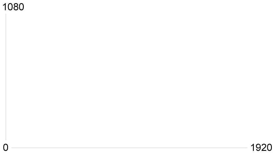

[EDIT] I made a mistake : zero-zero must be down-left because Y shift >0 is Up.

kevinshane wrote:
Amazing JOB!!! please tell me about how to calculate the new x and y lens shift when the original render has its own lens shift!!! It's very important!!! for example , original render res is 1080P with X lenshift=0.5 and Y lenshift=0.2!! Please tell me how to do the formula!!!!Thank you so much!!!!
just a bit of geometry ...
here a calc file with formulas assuming zero-zero is the down-left of the image.
For sure, vigneting and post proc will not work well that way.
REGION.xls
(18 KiB) Downloaded 403 times
