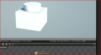

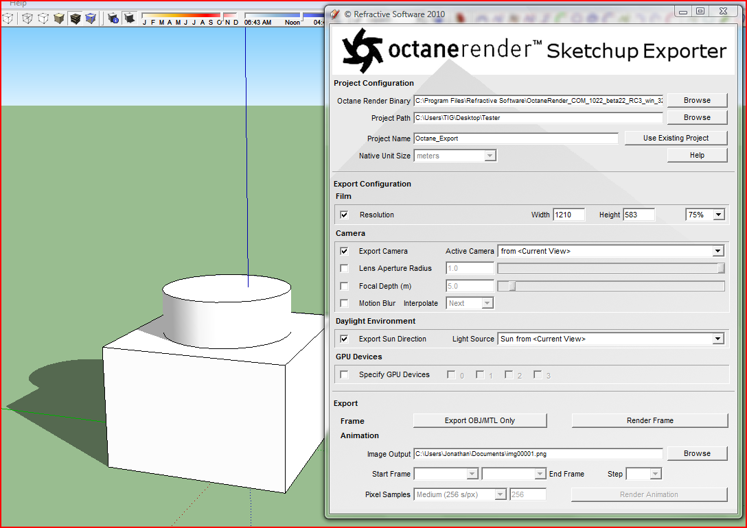

Here's a zipped set back.
I exported it with camera, resolution at 75%, and sunlight.
It works fine - see the OCS included.
The only reason I reduced the exported resolution is to get it to fit on my screen easily
The reason I set sunlight was that your default material is pure-white so to get some 'modeling' you need lights etc... I also show a screen shot of the dialog to show my Exporter settings and OCS.
