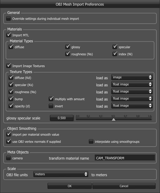

This 'changing of materials' is an Octane issue not an Exporter one per se: the exporter simply exports 'everything' available and Octane sorts out what it will and won't do with the data. For example - currently the exporter includes the materials' transparency in the data, but Octane always chooses to ignore that and on a first import of that material, and it uses 'opaque' for all... and you must then adjust the material in the ocs and save it. However, subsequent re-exports and renders using the same named material should keep the materials' transparency as last set in the ocs and ignore the current skp's value as ever.

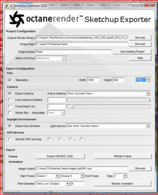

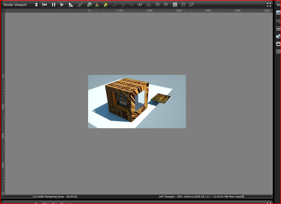

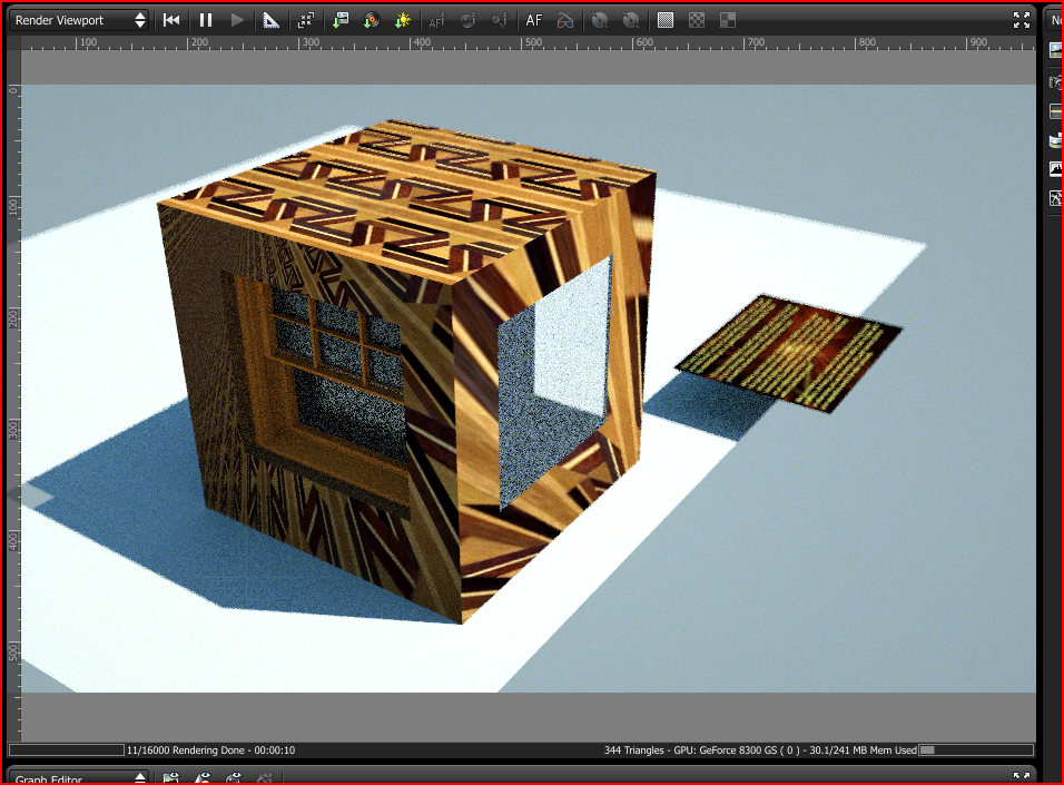

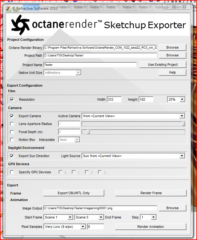

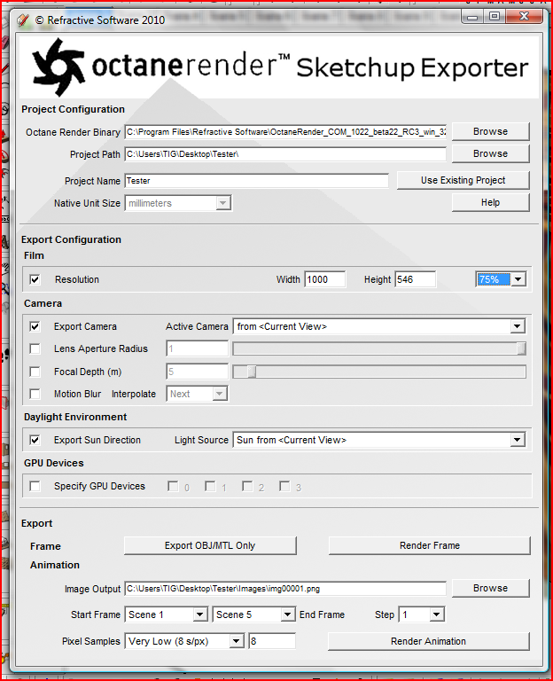

redmotion wrote:When I export from Sketchup the resolution doesn't get set correctly.
Is there a work around for this?
If you have set the Resolution in the Exporter's dialog and have the appropriate options 'ticked' to be included in the 'Export Configuration - Film' settings then it should be taken into 'Octane Render' OK and use that as the image size it starts rendering.
This has always worked fine for me...
Note how you must 'Reset' the Resolution from the drop-down list to revert back to the screen's original 'full-size' values - so if you take it initially as 50% it'll render at 'half-size' but if you then do another 25% it's now a quarter of what you have just set it to - not a quarter of the original full-size. To make it a quarter of the original full-size first use 'Reset' then take 25% of that.
Can you explain exactly what you are trying to do - perhaps post a screen shot of the dialog as you have it set just before you press 'Render Frame' :?
I've attached my working settings and renders...
