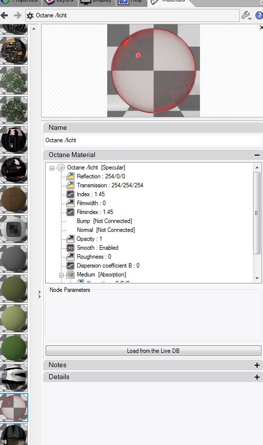

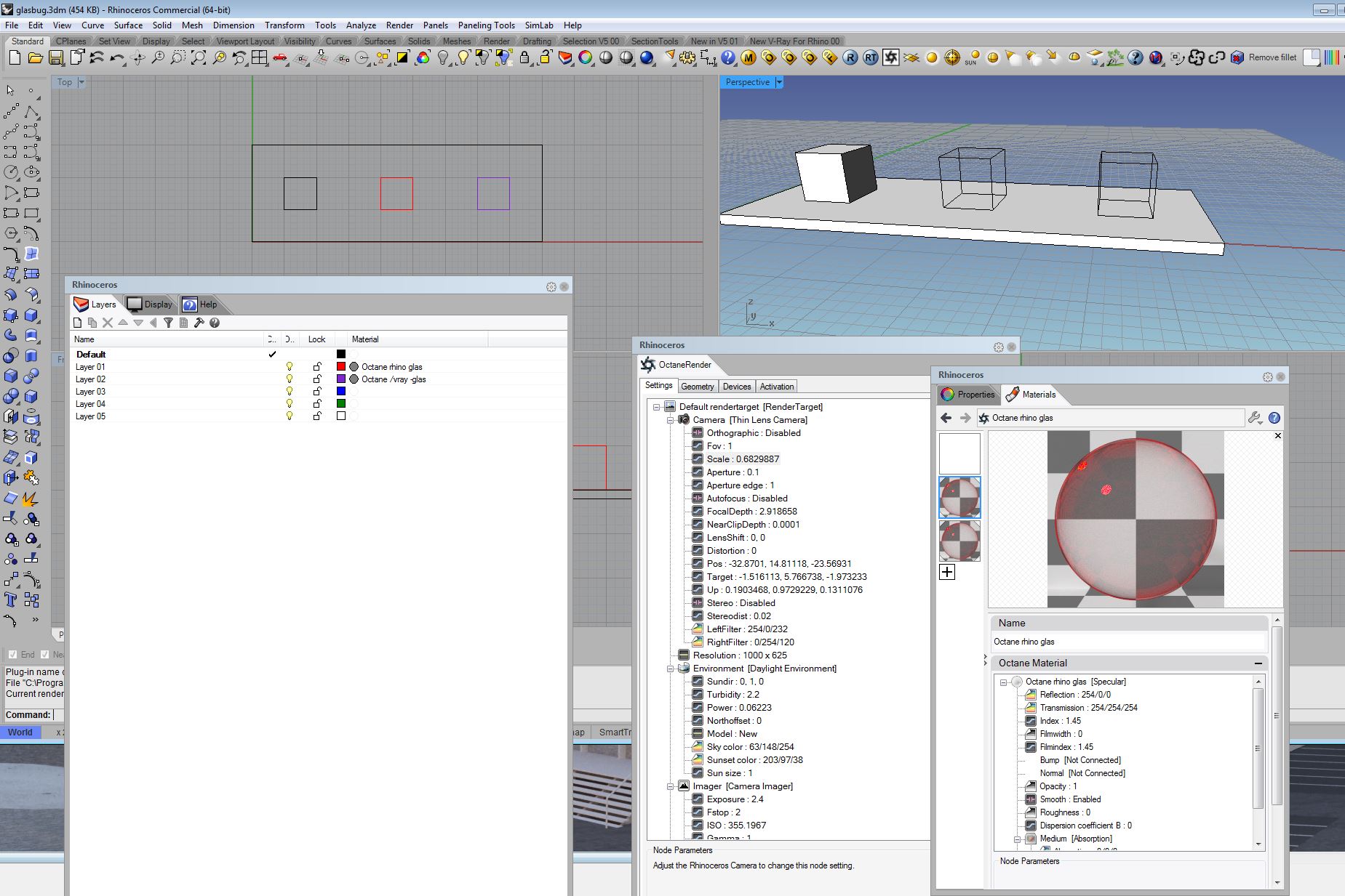

2. Material conversion from vray materials
I still experience some oddities e.g. a former vray glass material gets converted to a specular material with a color value of 0/0/255 in the reflection slot...
materials with glossy layers are initialy converted th octane glossy materials with a specular value of 1, independent of the former intensity

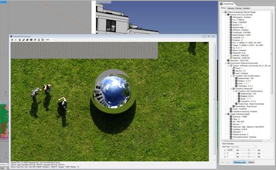

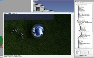

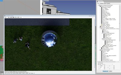

3. HDRI orientation
yesterday I tried to light a scene with an HDR image which was casting clearly visible shadows in its initial position. However when trying to rotate the image by changing projection from the default UV to spherical, then opening the 3d transformations of the spherical projection and modify the y value, the background in the octane viewport is indeed changing but the light is altered in a strange way... I tried to illustrate the phenomenon with the help of the tree attached pictures:
the first picture shows the situation with the original orientation of the hdri file with high contrast shodows
the second and third show the same scene with only the y value of the hdri rotation altered by 90 / 180 degrees. While one can see the orientation of the main light source is rotating, the light balance is completely different, darker and much more diffuse. I would expect that the initial sharp shadow just travels around the sphere...
Another thing which is especially time consuming to correct is that I sometimes end up with 2 or 3 duplicate (same named) materials.. could this maybe be connected to materials which are in some cases applied on an object level, in other on a layer level or in blocks? Could there maybe be an option to remove orphanage materials and/or duplicate materials?
Vray materials get first converted to a Rhino "Basic" material, then from there to an Octane material. It may be the Vray to Rhino step at fault, or the Rhino to Octane step. Would it be possible to send me a RMTL file from a Vray material which is causing these issues pls, and I will investigate.

3. HDRI orientation
Can you try exporting the unrotated scene to Octane Standalone 1.25, then add the spherical projection and try rotating. Is it happening there? Also, try unclicking then clicking the Importance Sampling checkbox. A few people have reporting HDRI issue with 1.25, so the next release may fix this.

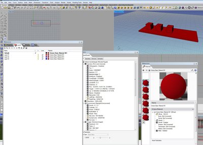

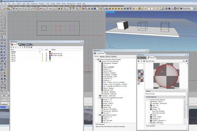

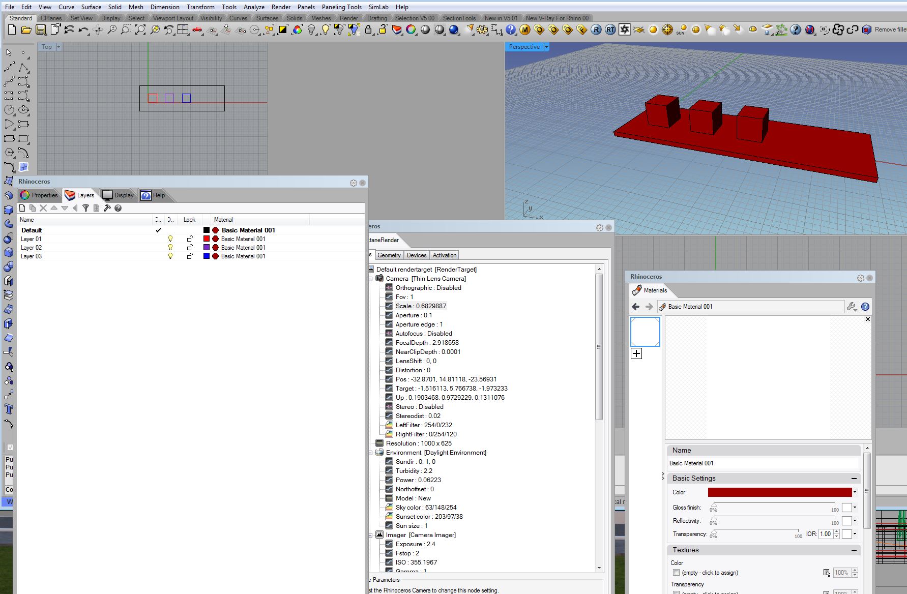

I took another look at the duplicate material issue and it seems that during the automatic, right click triggered material conversion process, octane creates a separate material for each layer, regardless that these share just one single material ( please see attached pics...)
This behaviour is the same for both vray or native rhino materials.

I took another look at the glas Problem,
like you suspected both the rhino material and the vray material are showing the same effect... the rhino material was a basic material with 88% reflectivity and 92% transparency....
best
