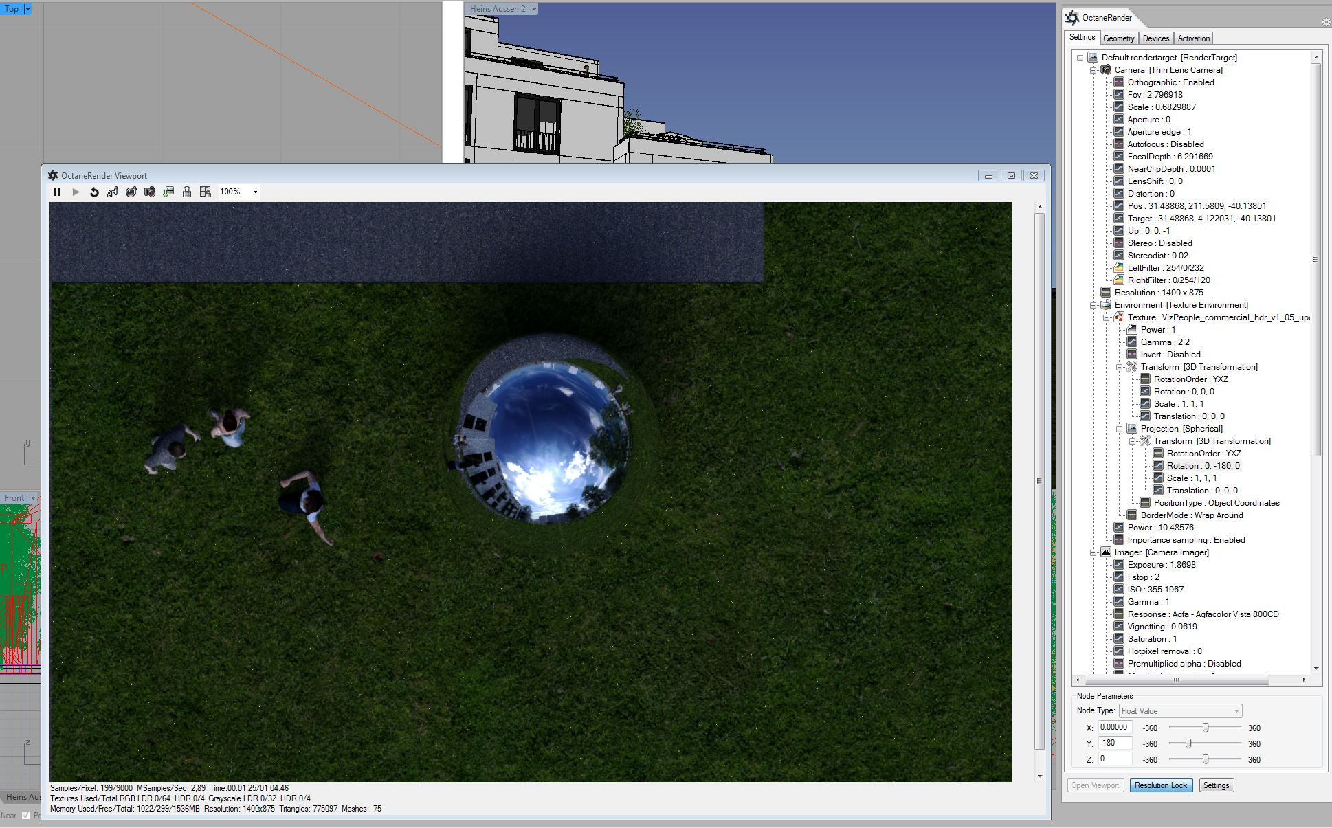

3. HDRI orientation
yesterday I tried to light a scene with an HDR image which was casting clearly visible shadows in its initial position. However when trying to rotate the image by changing projection from the default UV to spherical, then opening the 3d transformations of the spherical projection and modify the y value, the background in the octane viewport is indeed changing but the light is altered in a strange way... I tried to illustrate the phenomenon with the help of the tree attached pictures:
the first picture shows the situation with the original orientation of the hdri file with high contrast shodows
the second and third show the same scene with only the y value of the hdri rotation altered by 90 / 180 degrees. While one can see the orientation of the main light source is rotating, the light balance is completely different, darker and much more diffuse. I would expect that the initial sharp shadow just travels around the sphere...
