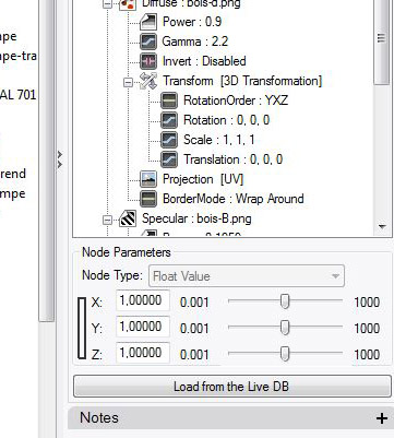

maybe something like this? not too pretty (my ps skill is a bit limited at the moment because I broke my shoulder last week...) but would do the job... it could freeze all 3 values at the same number or even freeze the 3 sliders in their relation to each other in case the values are different...
best regards
andreas
Architectural Rendering Services
1 x 4090 GTX, 1 x 3090 GTX
http://www.v-cube.de
Bendbox
Posts: 478
Joined: Wed Aug 21, 2013 1:38 pm
+1 for this feature. I like something similar to what V Cube has mapped out. This makes it easier for new users, otherwise you wouldn't know it was there.

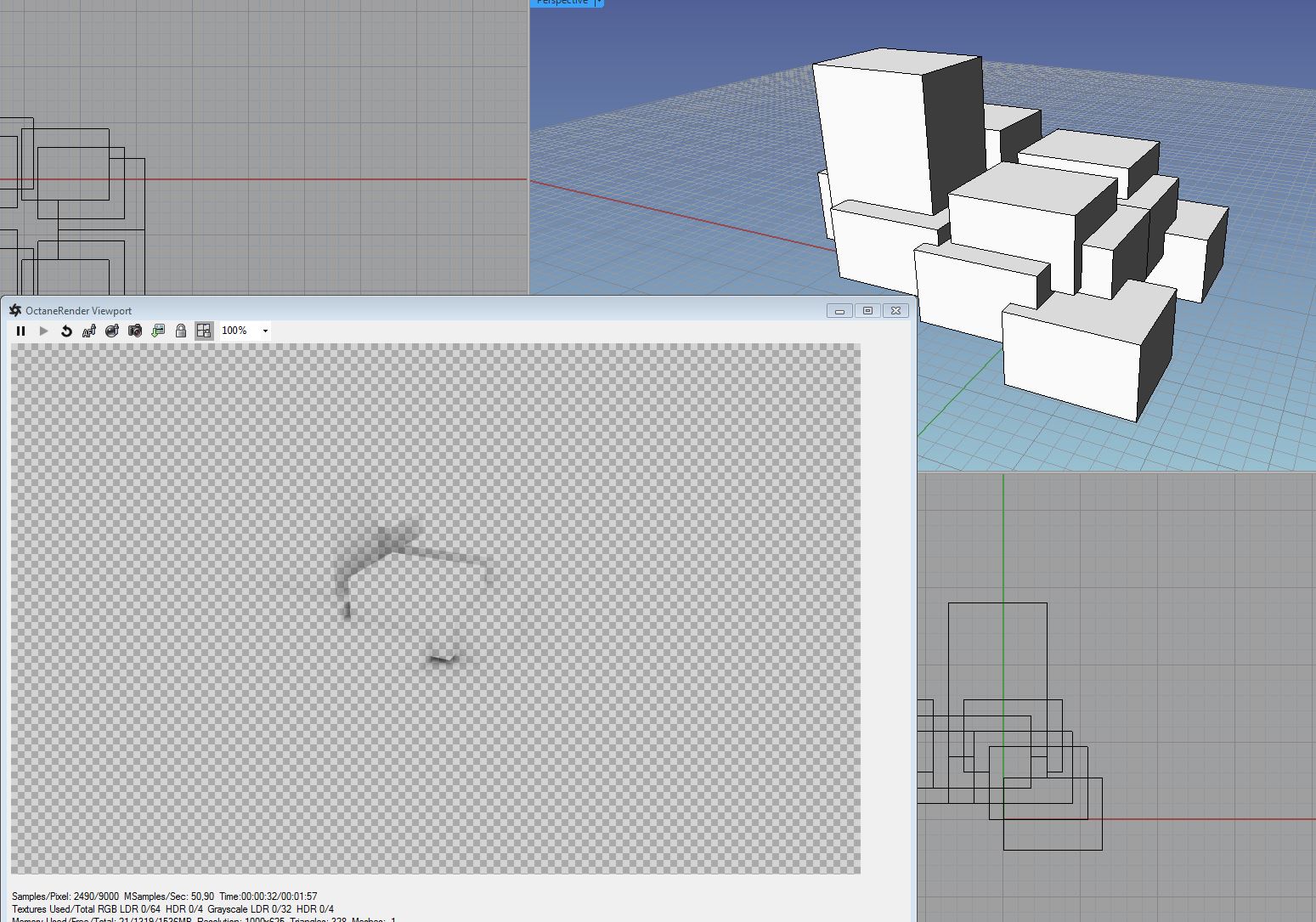

when i open the octane render window in a very simple scene (only one object, new scene...) my initial render window is looking like the attached pic, it seems that only some very subtle shadows in the corners are rendered, the rest seems 100% transparent.
It seems to be related to the default daylight environment settings somehow, because by simply assigning first a texture environment and then again the daylight system, everything starts to work again...
another thing I observed is that my vray glas objects now translate with a deep red color in their diffuse channel...
best
Andreas
face_off
Posts: 15794
Location: Adelaide, Australia
Andreas - can you pls delete C:\Users\[username]\AppData\Local\OctaneRender for Rhinoceros\rendertarget.xml - I think the old version of the default rendertarget is not compatible with the Octane 1.25 one.
Does that fix the problem?
Paul

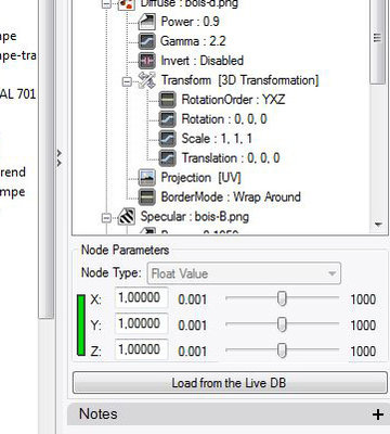

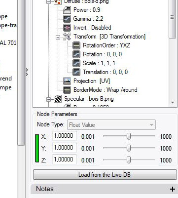

I have refreshed the installer at the top of this thread with:
1.25.0.4
- Added "lock" button to the "scale" pin sliders (on the far left of the X, Y, Z labels in the Node Edit box). Enable to move all sliders at once.
