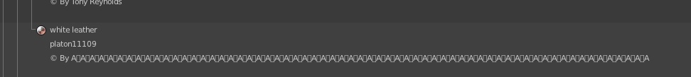

seems to be a naming error in the liveDB, does anybody else have this one?

JimStar

afecelis
Do you have some national symbols in .blend file path?

JimStar
Posts: 3845
afecelis
Can you please check if you have the "livedb" folders created in "Program Files\OctaneServer" and in the folder containing your opened .blend file?

Natato
Posts: 30
Joined: Fri Nov 04, 2011 10:55 pm
JimStar wrote: Do you have national symbols in OctaneServer or Blender installation paths?
Jim, I do not have national symbols, the folder "liveDB" is not in "Program Files \ Octane Server"

JimStar
Posts: 3845
Natato wrote: Jim, I do not have national symbols, the folder "liveDB" is not in "Program Files \ Octane Server"
Thank you!
