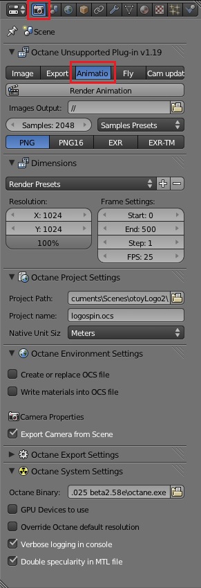

Hi Megacal,
Yes, there should already be this option in the plugin:
Chris.

orion_uk
Posts: 713
Joined: Tue Oct 25, 2011 2:56 pm
FooZe wrote:Hi Megacal,
Chris.
HHMMM strange!
I have this option selected BUT when I choose Render Animation, Octane render pops up, renders the first frame, closes and does not `pop up`/open again to render the following frames :(

orion_uk
Posts: 713
Never mind, matej showed me a solution...thanks matej ;)
