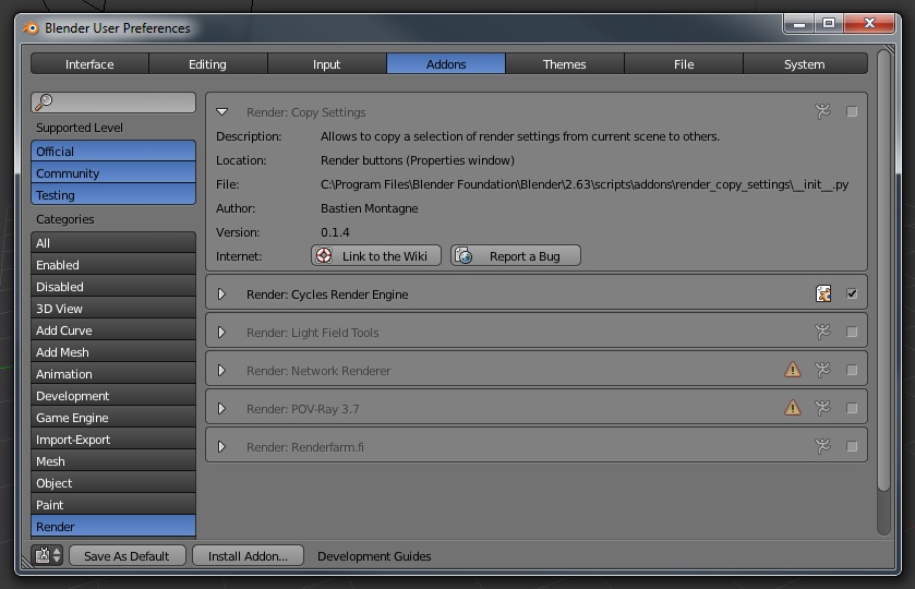

So I installed all of the plug ins form the folder into blender. But how do i enable it. I do not see octane under export-import in the add ons menu.
How do i do this?

Just download the latest version of the importerlarmannjan wrote:I am still trying to get he exporter installed but I can't seem to find it anywhere.
go to addins, then add a new addin - select the zip file containing all of the .py files
it should return you to the addin dialog, you then need to scroll down and enable the octane addin
Once that's done you'll have Octane listed as a render option, but you;ll need to setup the path to your Octane executable
Watch the video below it goes into some detail on how to set up after this stage
