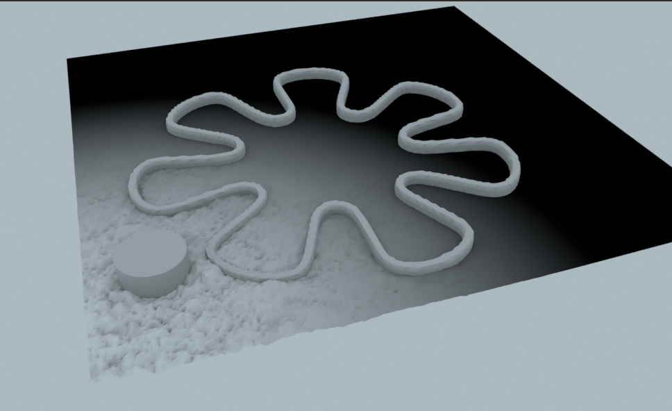

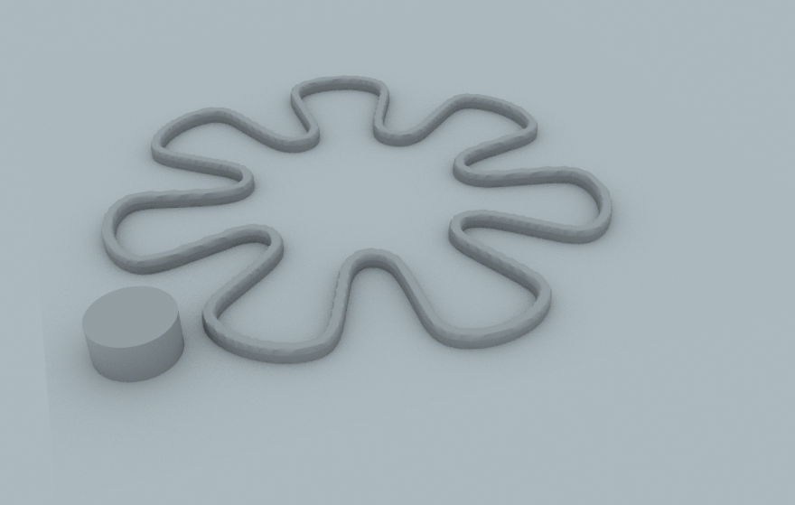

Export problem to Standalone while using Field Texture. Attached scene.
Offset parameter doesn't work in C4D plugin.
Shift key while dragging Fallow and Offset doesn't work.
Fallow parameter in Field texture works fine when shape object is regular SDF primitive :
But it clamp values over 1 if c4D object is used with Mesh to SDF enabled :
ORBX included.
Here is video : viewtopic.php?f=24&t=81415&start=30#p424961
ORBX included.

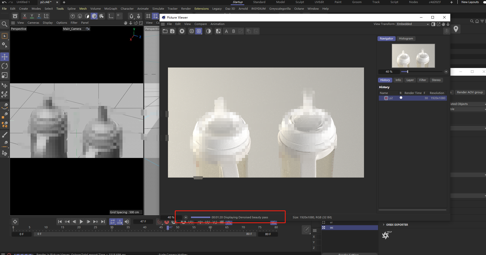

I have encountered a serious problem where the image cannot be stored after rendering is completed, and closing the picture viewer will result in c4d not responding.
I tested with many different projects, and they all trigger bugs, especially when a project renders output for the second time (output overwrites the previous image), it will appear 100%
c4d 2023.2.1
rtx4090
drive 535.98
c4d 2023.2.1
rtx4090
drive 535.98

It's happening on some setups when render AOVs are used. Work around is to disable the "show passes" parameterblackcat321 wrote:I have encountered a serious problem where the image cannot be stored after rendering is completed, and closing the picture viewer will result in c4d not responding.
c4d 2023.2.1
rtx4090
drive 535.98

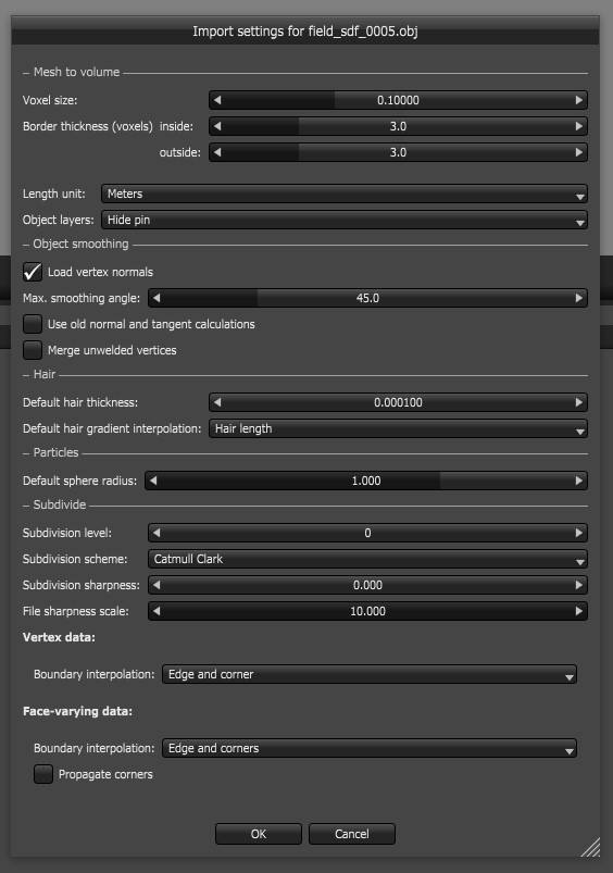

Octane C4D plugin has missing features for SDF objects in Mesh to SDF option from Octane Object Tag. Missing features are :
1. border padding outside
2. in the import/conversion settings at the top called "Border thickness (voxels)"
3. border thickness in/out parameters
we don't have such features : viewtopic.php?f=24&t=81415&start=30#p425019
Also there is export to ORBX issue while using Mesh to SDF

Hi there,
what was again the problem, if octane never finishes a rendering?
Thought there was a solution for that problem, but I don't remember.
Render is ready, but status still saying "Render progress..." and it never stops/saves.
"Show Passes" already disabled!
regards
Mike
regards
Mike
