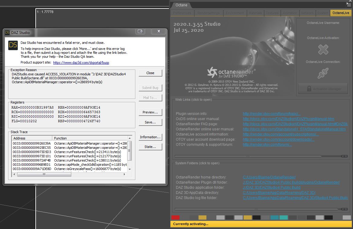

I still get the same crash i have no clue what they did i did not touch anything on my system at all and then i started to get the crash so its on otoy's end something changed and i cant use the new 2020 builds at all anymore, and i have changed nothing with my system or daz over that period of time from working to crashing.face_off wrote:I have updated the installers at the top of this thread with:

Thanks for the crash report. I have forwarded it to OTOY.I still get the same crash i have no clue what they did i did not touch anything on my system at all and then i started to get the crash so its on otoy's end something changed and i cant use the new 2020 builds at all anymore, and i have changed nothing with my system or daz over that period of time from working to crashing.

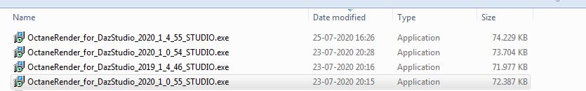

I have all these i have been trying with
Have even been trying to redownload them all and try again and only OctaneRender_for_DazStudio_2019_1_4_46_STUDIO works now

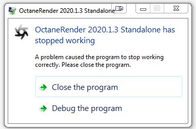

I found version 2020.1.3 and it crashed on startface_off wrote:Do you have the latest NVidia drivers installed? Does Octane Standalone 2020.1.4 render on that PC?Have even been trying to redownload them all and try again and only OctaneRender_for_DazStudio_2019_1_4_46_STUDIO works now
Paul
i have no clue what is going on.
all my problems came after Octane X
don't use to much time on it if i am the only one then i will just go back to iray or older version of octane
