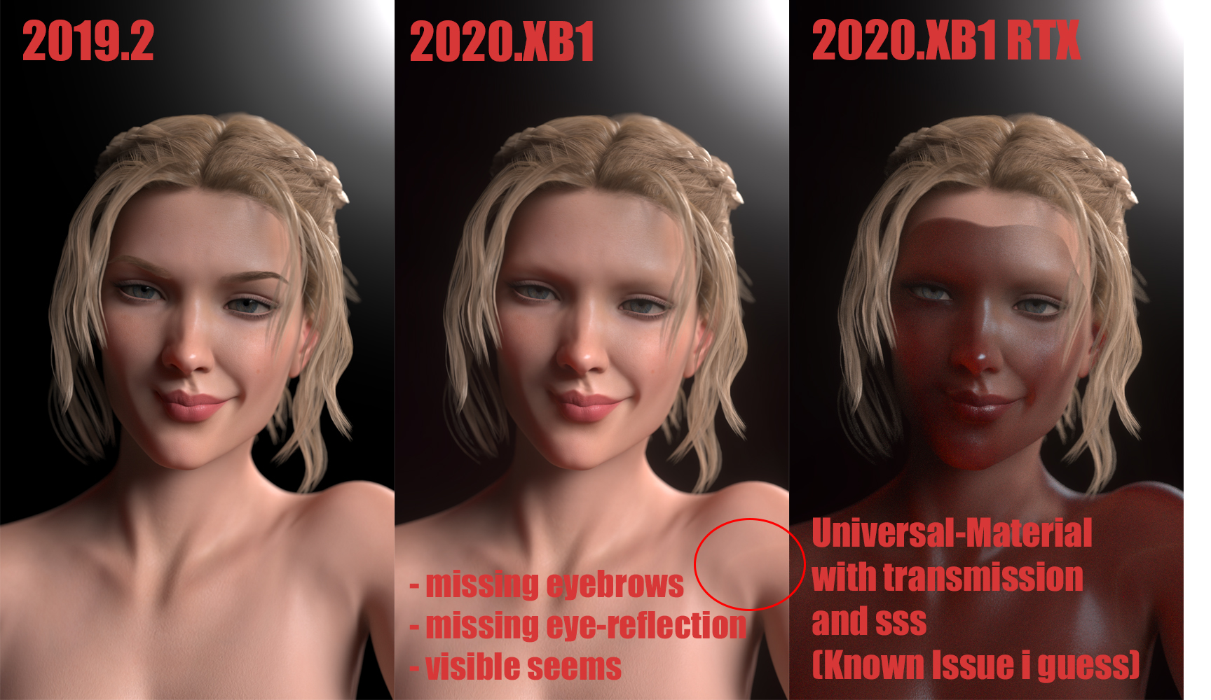

The first's tests are sobering. Same scene rendered with 2019.2, 2020XB1 and 2020XB1 with RTX.
In the 2020XB1 without RTX the eyebrows went missing, eye reflections are gone and seems between surfaces appear visible. With RTX enabled there are more issues but i think i already read in the main 2020XB1 thread there is an issue with universal materials and transmission. From render passes the error appears in the diffuse layers.
Second Problem (SOLVED)
Missing Eyebrowse and Eye-Reflection due to Surface Material Filter reset in Preferences after plugin update.
First Problem (SOLVED):
I've tried to render a scene from 2019.2 but it just returns a greyish noise on the diffuse channel, everything else is just black. The octane log says its trying to access an invalid pin, P_FILM_SETTINGS. Which pin is this? is it a node on the materials or in the settings? Can i reset this somehow? I've got the current NVidea treiber 441.xxx and i'am using 2 RTX 2070. I've already deleted the OctaneRender_settings.oczdb file and restarted. I tried it with and without RTX enabled.
Sorry you had these issues. I have not made any code changes that would effect this issues, so I can only guess that they are related to Octane 2020.1. It would be interesting to see if you remove (or disable) all geometry other than the eyes - are the reflections still missing in 2020.1, but present in 2019.1? In which case, is this issue reproduced in Octane Standalone if you export the scene (with just the eyes) to .ORBX.
May I suggest if you have differences like you are seeing, try to export just the effected geometry in the 2019 and 2020 version of the plugin, and see if the problems are reproduced in Octane Standalone. If this is the case, we can track down the problem more easily.
Paul
Thank your for your response and offer to have a look into it. As soon as i have time i will dig deaper into it and provide more information.

About this problem with eyeybrows and other hair not showing. I allready had this happen with earlyer octane versions. Thats nothing new.
However .. i never could pin down why this was happening.
Ah yes, you are right. Was it something to do with the parenting of the mesh, or a prop that was attached to the head?
Paul
Cant be the head alone. I had this with all bodyheair that was fibre. I remember one could make it sort of visible when setting the rayepsylon to a crazy wrong value ... but everything else was "broken" then.
I am sure it had nothing to do with applyed shaders or maps cause i tryed to change those.
For me it happend all the sudden in scenes i had allready rendered fine before. Without changing anything inside the scene.
But a time ago it was all ok again (no idea why) ... didnt show since then.
Could be viewtopic.php?f=44&t=62180&p=317855&hilit=brows#p317855 too?
