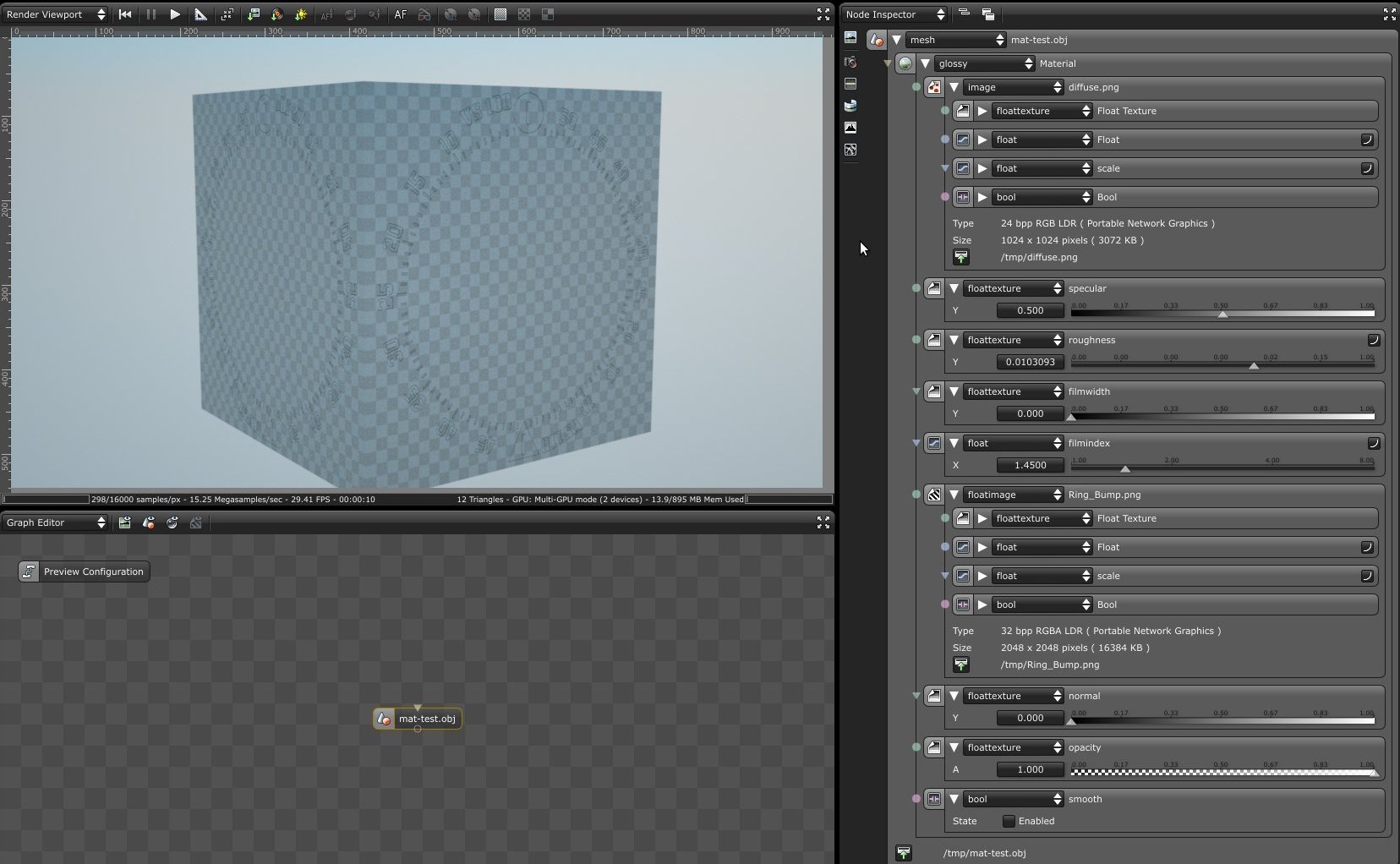

Thanks for the info face, now I have problems with materials, I had an object with two textures, a diffuse one, and a bump map, I deleted the bump map, and rendered with Octane (with overwrite project checked) and Octane shows two materials, instead of one, so doesn't update the deletition from blender, I don't know what happens, the script is getting mad with the materials updates.

Blender's normal maps are used as bump maps into Octane. The script doesn't go crazy with materials, check the generated mtl file and the command line options before claiming something is wrong.
The following is untouched output directly from blender (except pathtracing), with a diffuse texture and a bump map.
