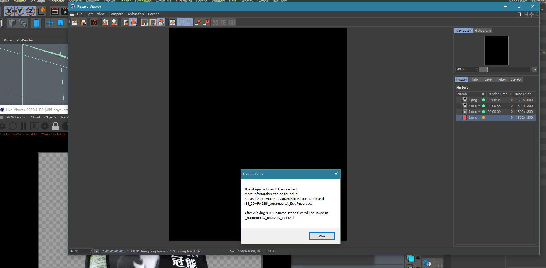

When I render the image to PV and switch the LV preview, octane often crashes. I've crashed several times in an hour, and I've uploaded multiple crash logs. I use 980ti * 2 and drive 445.87 win10 1909

blackcat321 wrote:When I render the image to PV and switch the LV preview, octane often crashes. I've crashed several times in an hour, and I've uploaded multiple crash logs. I use 980ti * 2 and drive 445.87 win10 1909
to give more info,
-on a specific scene?
-using RTX?
-tried to clear texCache?
-Using studio version of driver?
