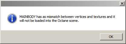

Just a little grammar thingy... or maybe it's just my Kiwi English... but should the "as" be an "a"..???
Anybody know how to fix this by the way?
