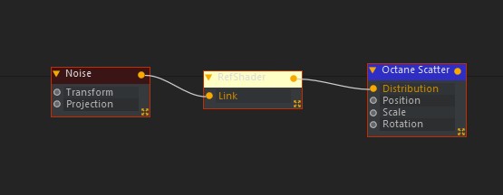

I noticed that RefShader doesn't work inside Scatter nodes. It correctly import values from reference noise node from another Octane Scatter object but unfortunately it do nothing - just like disconnected from node network :

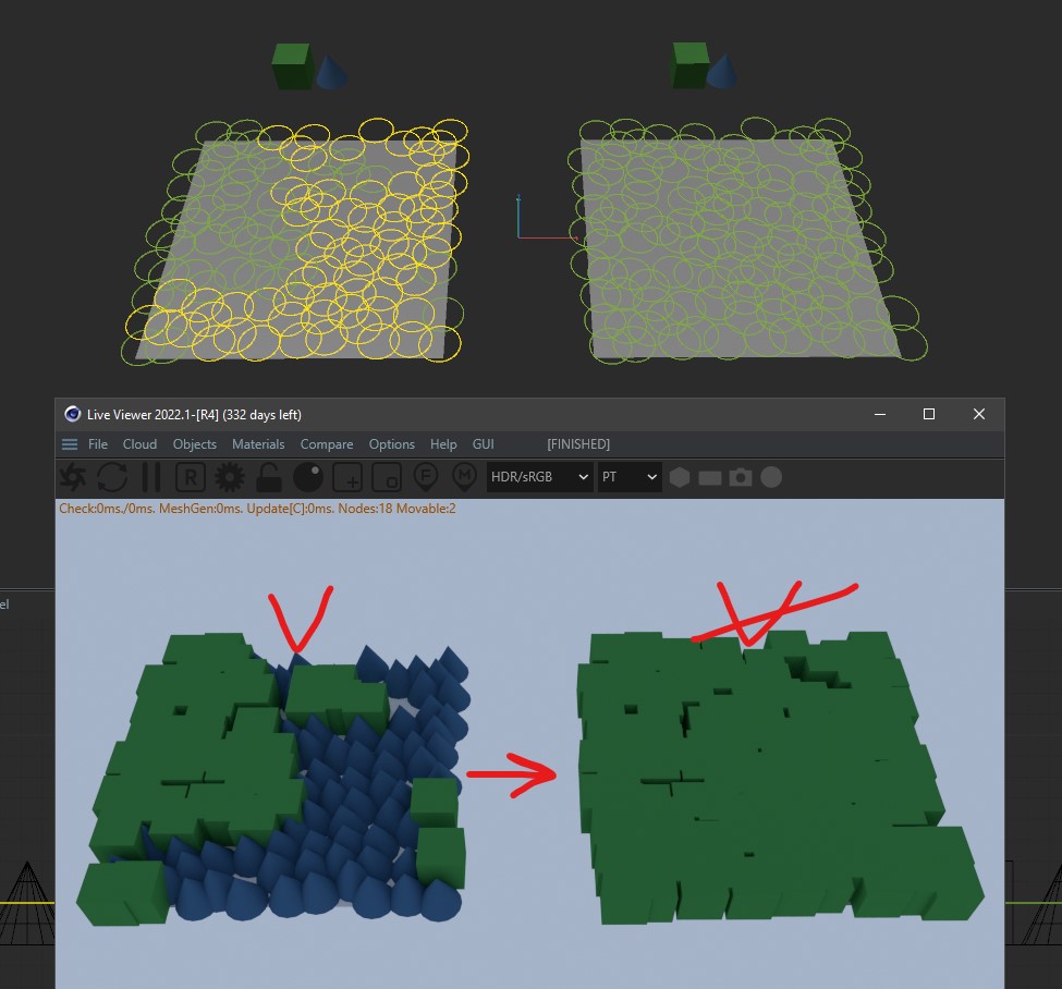

First example of refshader - Scatter 2 has connected distribution noise using RefShader from Scatter 1 but it doesn't work. C4D Gradient node probably can't be connected to RefShader :
Scatter RefShader.zip
(85.77 KiB) Downloaded 127 times

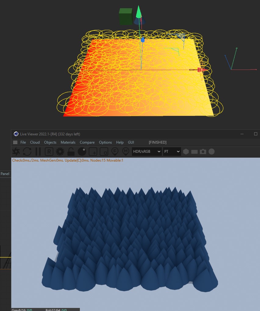

Vertex map by Scatter nodes doesn't work :
Scatter vertex by node.zip
(89.43 KiB) Downloaded 127 times
Your sentence is not fully correct because it works with old vertexmaps. But field+vertexmap is a bit different to catch the data and it's not yet supported in scatter. This support has been added for materials recently.

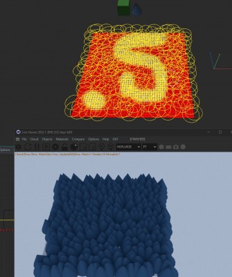

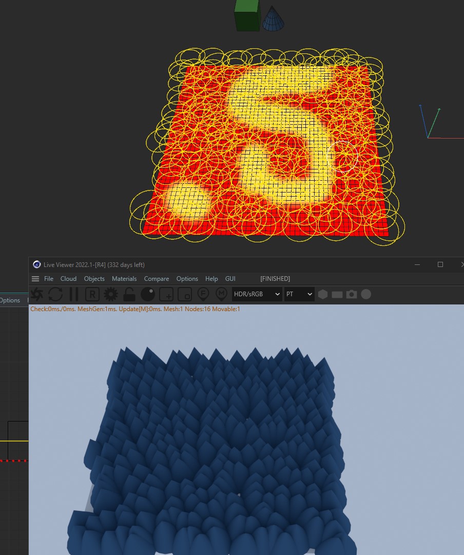

But regular-painted vertex doesn't work via nodes too :
Scatter vertex by node 2.zip
(112.69 KiB) Downloaded 139 times

SSmolak wrote:
aoktar wrote:
The attachment scatt_vert 2.jpg is no longer available
it works, change the "limit".

aoktar wrote: it works, change the "limit".
Yes here it works perfectly as always but it works little different than distribution map of individual clones. It works here like overall clones limiter which is good but not the same like noises from Scatter shader input. This is why I tried to connect vertex to distribution input in Scatter nodes.
