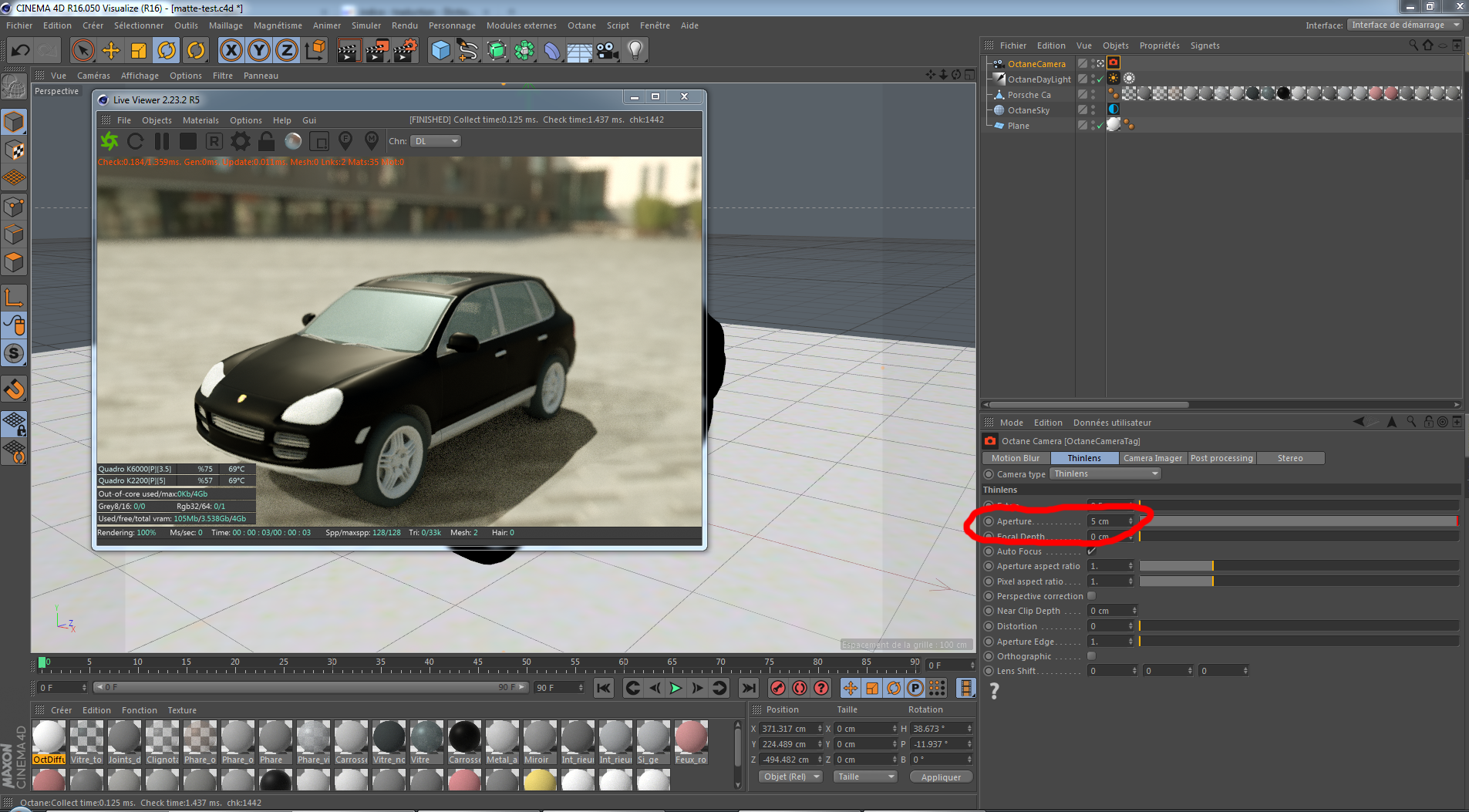

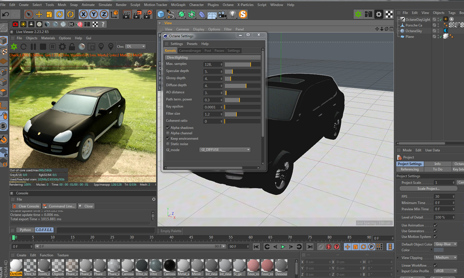

bloodyriton
Posts: 23
Joined: Mon Mar 31, 2014 2:29 pm
aoktar wrote:
bloodyriton wrote:
Hummm very strange, I used exactly the same scene, and also rebuild one, cuda is up to date...
But still the same :(
Any clues ?
This is my result and scene.
Ok, but I add a camera with an aperture of 5.
Look with the 2.21.1 it works, but not with the 2.23.2 r5 :(
