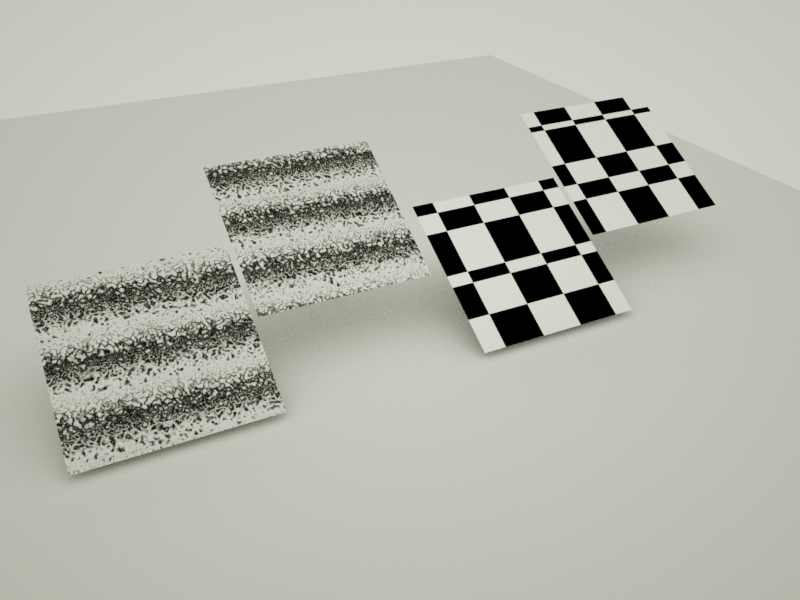

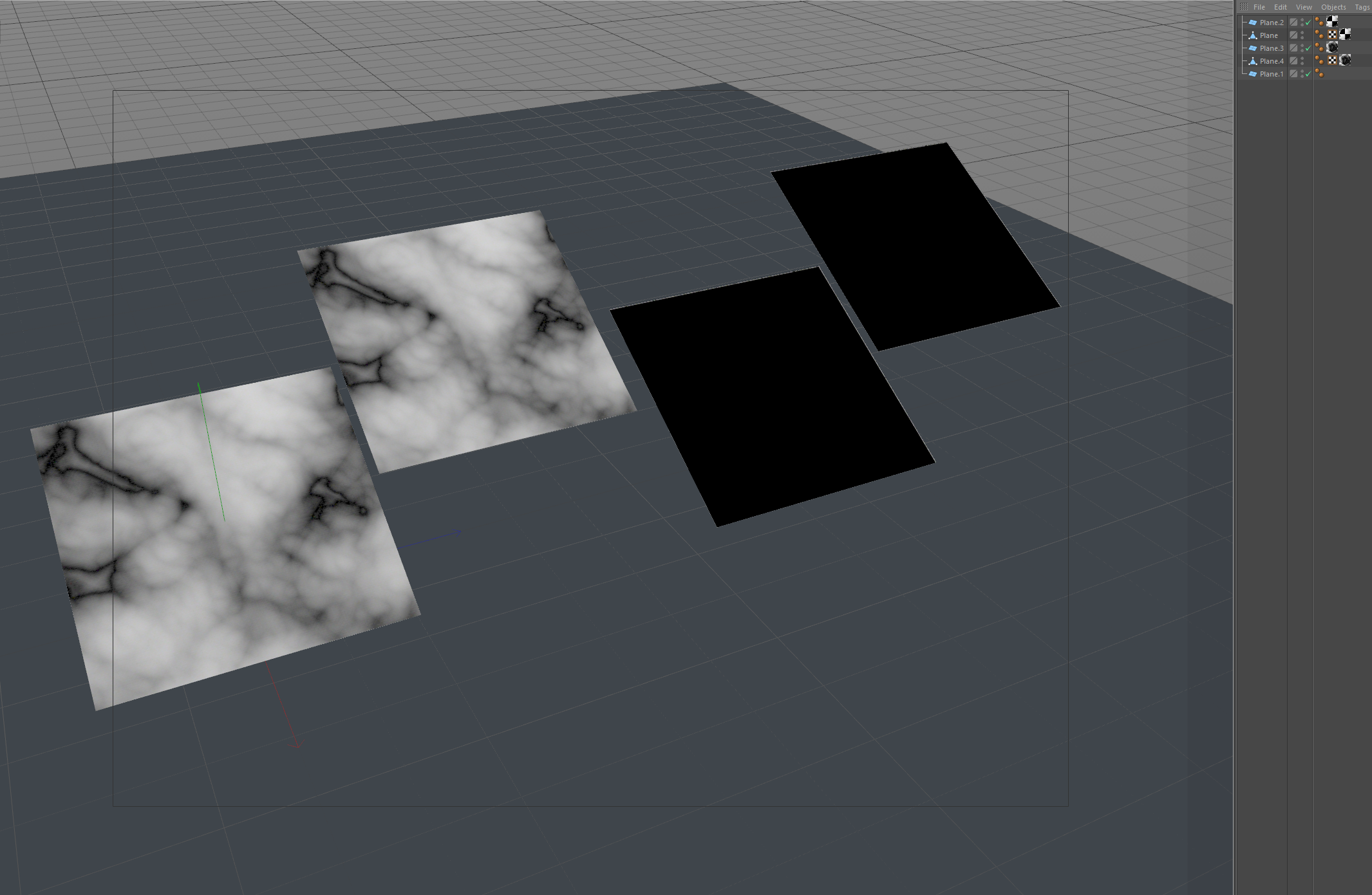

Hey Aoktar, I've run into a problem with the octane image generators such as the marble/checker. When using the generators they seem to not obey the objects UV so as the object moves the material does not move with it. Along with that some of them don't display correctly in the viewport.
Posts: 16066
Location: Türkiye
shawnfrueh wrote:Hey Aoktar, I've run into a problem with the octane image generators such as the marble/checker. When using the generators they seem to not obey the objects UV so as the object moves the material does not move with it. Along with that some of them don't display correctly in the viewport.
i know, this shaders are working on 3d coordinate system. We need support for 2d mapping for this. And i like to say next SDK has it.
