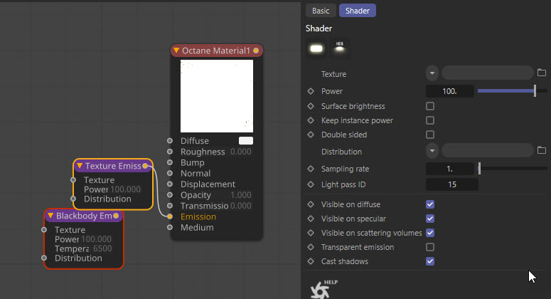

SilentPartnersStudio wrote:In the texture emission, the lightpass attribute has not been adjusted to accept values higher than 8.
What's the version number that are you using?

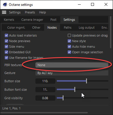

Can we have the option to remove this automatic material connection when importing images?
Right now if I drag eg. a normal map, it also drags in node editor, roughness and bump.
No matter how many times i ll try drag just 1 image it draags multiple that i dont need. Then if there are multiple LODs in same folder (which is very typical from quixel), when I try to drag LOD0 from normals, just adds 3 other normal maps but not LOD0.
Just a few cases that happened today thats why i remember specifically. But yes, to my request: can we have an option to disable this behavior?
Other than that r7 is great!
Posts: 16068
Location: Türkiye
thanulee wrote:Can we have the option to remove this automatic material connection when importing images?
Not sure what do you mean exactly with that! It's here in picture how to activate/deactivate the PBR texture detection/connect option if you talk about it!

thanulee
Posts: 712
Joined: Sat Dec 19, 2015 11:00 pm
That was exactly what i was looking for! thanks
Keep in mind that with this option emabled, when I drag textures from a folder to node editor, brings random textures in and not the ones that I select. But good to know that I can disable this behavior.
