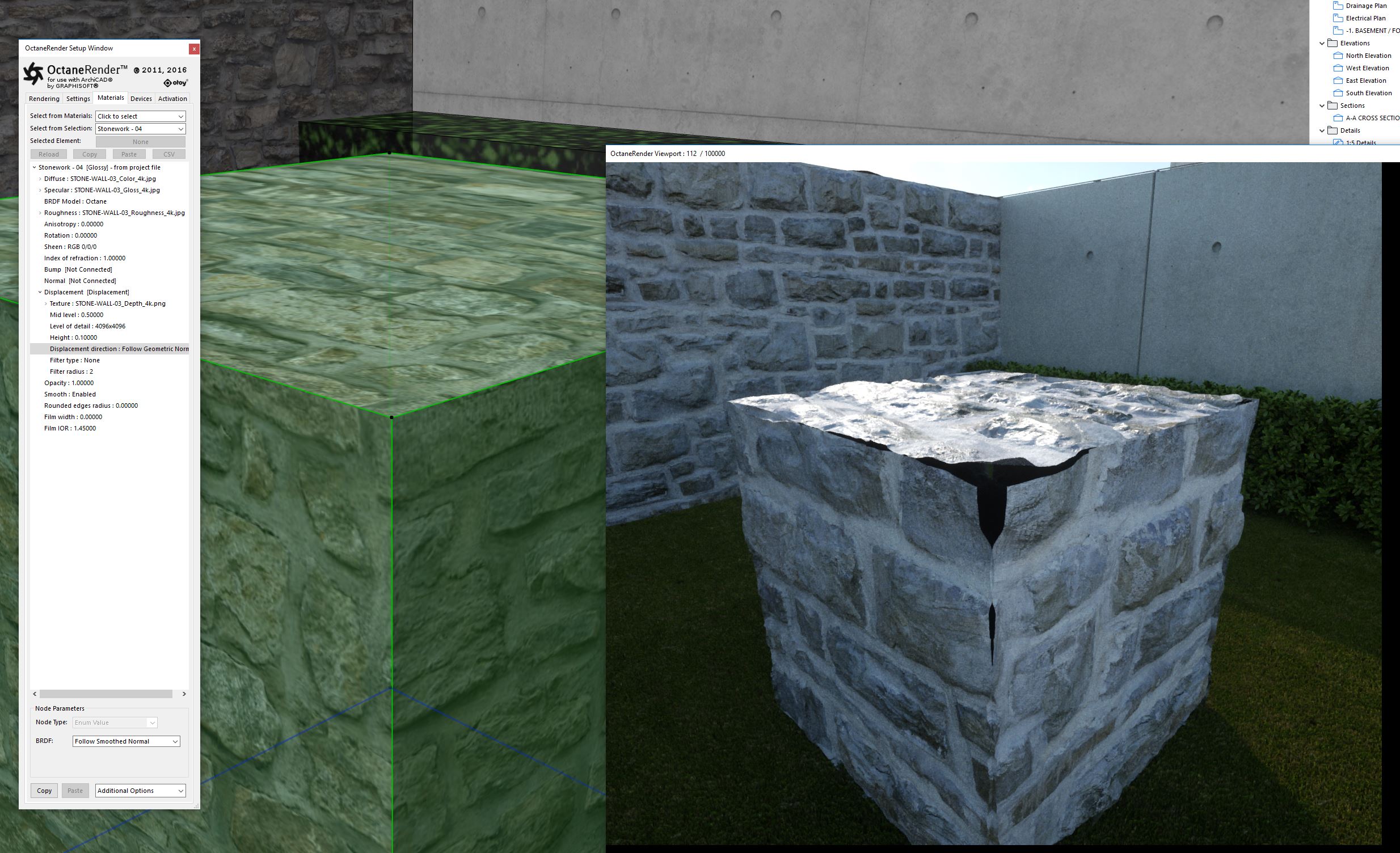

Hi Paul,
I'm still not having much luck with this sorry.
I am observing the following;
Selecting Follow Vertex Normal, or Follow Geometric Normal, both end up with the Follow Vertex Normal settings.
Selecting Follow Smoothed Normal ends up with the Follow Geometric Normal settings.
I'm getting the same behaviour with both the AC20 and AC21 plugin.
Thanks - I have located the problem, and it will be fixed in the next release.
