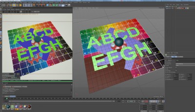

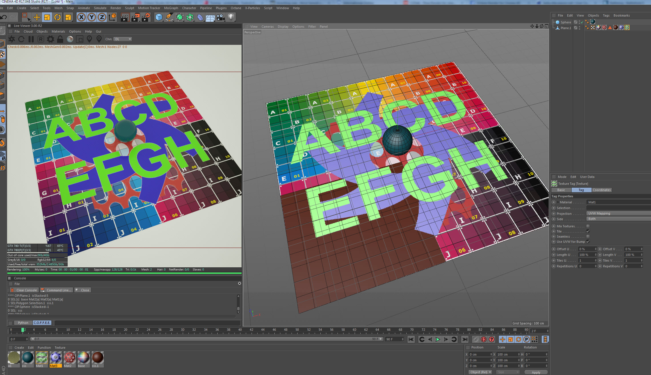

I just installed 3.0R1.1, and all seems well, except for the fact that the Live View will no longer allow for camera orbits with alt-left-mouse. The view will properly behave until I release the mouse button, at which time the view will snap to the state of view as when the file loaded into Cinema. Pan and Zoom seems fine, this is limited just to orbit. I looked for a setting to control this, but I cannot find one (and this would differ from previous versions regardless). Is this a known issue?
Cinema R17.046 running on Win64 8.1
Update: Light Colors are not updating either. I think I may have a bad install, though I did follow the directions... I will investigate further.

OK, I found this camera issue. This is an imported LWS file, and apparently there were keyframes on the camera. As such, the Octane viewer jumping back would likely correct in this case.

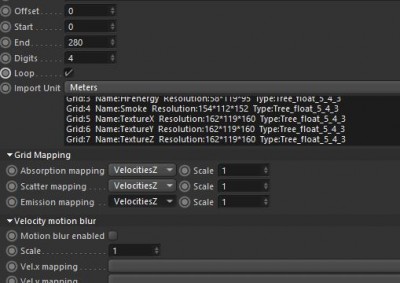

Thanks for trying to helpdinf wrote:Could be a possibility. Mind posting me one file?valters wrote:VDB made wrong? - Vdb provided by my friend using FumeFX
p.s. from all what I read guys got VDBs from Houdini most. Looks time to learn it :/
- Attachments
- mv_def_v001_0065.zip
- (5.66 MiB) Downloaded 267 times

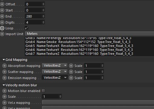

Thats what I use to look after it.valters wrote:from all what I read guys got VDBs from Houdini most. Looks time to learn it :/
There are 10 VDBs in, VelocitiesZ is the last one. But they all seem to have 3 values, even the x, y and z volumes. Don't knwo why Octane takes the last one of all things, but 3 values in every volume seems to be a bit much.
Btw: Is it intention that all the volumes of frame 0065 have square or rectangle shapes?
