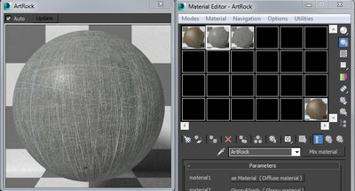

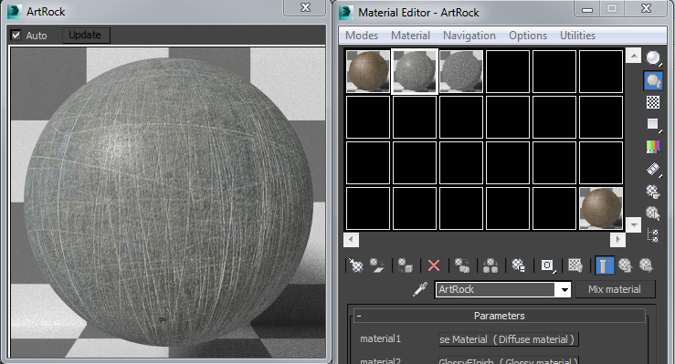

Is there a way to get a material preview with a shader ball?
For example like we have in max:
Is there a way to convert the whole scene to Octane materials at once (script)?
Or do I have to overide every single material at once?
Octane for 3ds Max v2.21.1 | i7-5930K | 32GB | 1 x GTX Titan Z + 2 x GTX 980 Ti
face_off
Posts: 15815
Location: Adelaide, Australia
I have implemented this previously, but it is not at a quality I consider worthy for public release. The Octane Standalone material ball renders on the fly, so you can tweak and adjust settings and the rendering of the ball restarts. However with plugins, the generation of the material preview blocks the UI, so you make a change, and need to wait for 500 samples to get the result. So I don't think it is useable. The Rhino plugin implements this by rendering the material thumbnails whilst the app is idle. In Modo, the plugin generates thumbnails for presets when you save to a preset. I'm unsure how it's done in 3ds max. So there is no live material editor like in Octane Standalone in the Modo plugin - sorry. Otoy would need to modify the API to allow this to happen.
