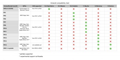

bepeg4d wrote:Ok, let's try to do a recap.
It was not possible to have a single OctaneX version supporting any type of Mac's GPU, so from some time, the OctaneX project has been divided in two:
  • OctaneXPR versions for AMD GPUs (Vega, Navi, Big Navi)
  • OctaneX 2022.1 or greater for Apple silicon M1/M2 native
Will OctaneXPR ever be upgraded to 2021, 2022? Or will it go no further than 2020? Thanks

Sorry, I don't have an official answer on this, I can only share my personal opinion, and it is not positive.
Since new Mac Pro M2 cannot use PCI AMD GPUs, I don't think there will be a future for AMD support from Apple :roll:
Let' see.
My two cents.

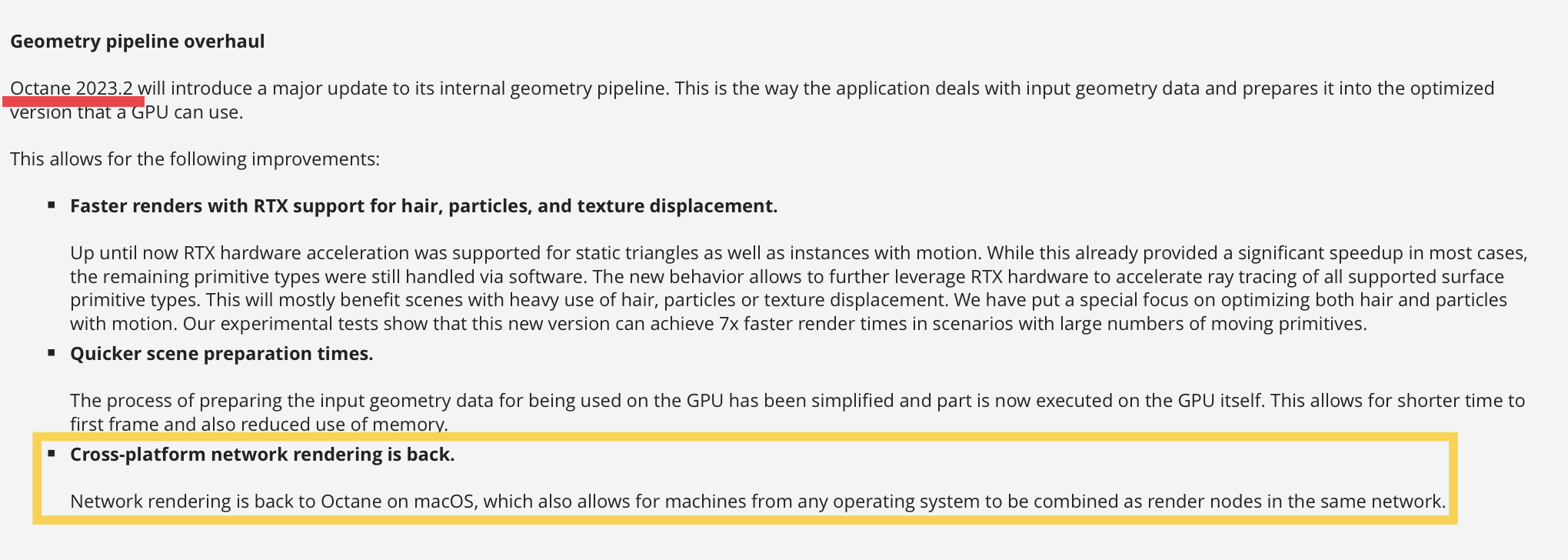

Hi cjadams,
nope, Network rendering is not currently available in OctaneX M1/M2 versions, but, since they are distributed in free Prime license only, you can use C4D Team Render with unlimited number of nodes (normally you should need a Studio+ license per node).
For full multi platform Network rendering we ned to wait for next 2023.2 major SDK update, with new revisited geometry pipeline:

Do we have any idea on "tiime frame" fo this update?
