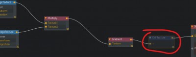

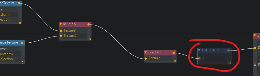

Disable OSL node cause that all tree is disabled too :
