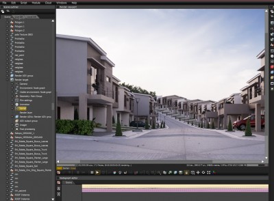

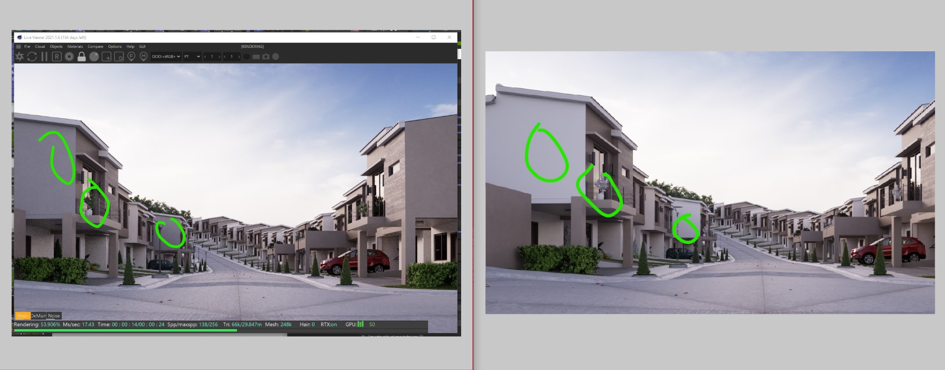

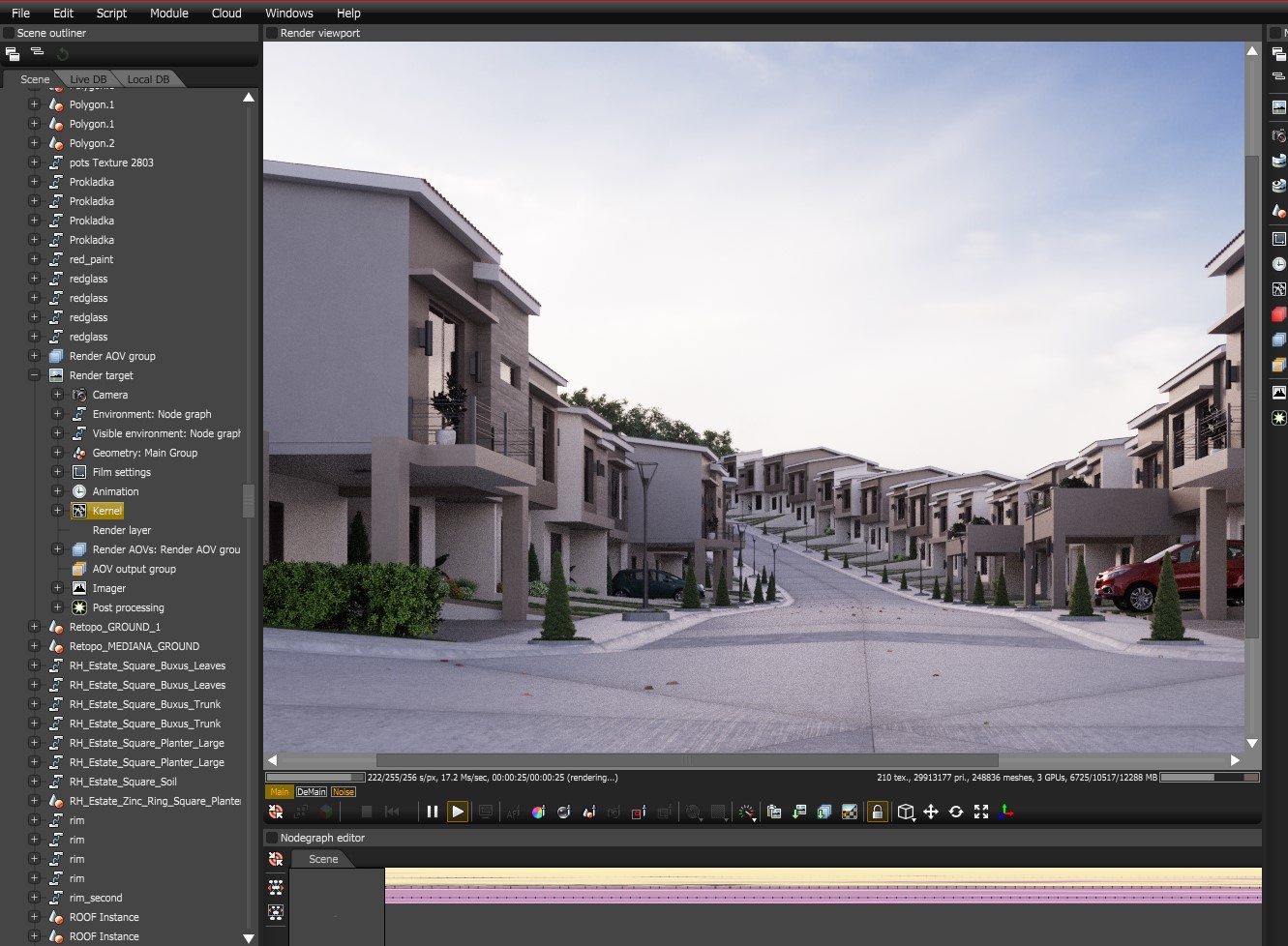

Hi, Aoktar
Thanks for the update on plugin side!
With a recent problem I have now. Why does this keep happening???
It renders nice on "Liveview Window", and renders sloppy white on some shaders on "Picture Viewer".
And it sometimes randomize which shaders are rendered correctly, other times are not... very frustrating.
What this bugs share in common is that all are in instances or render instances.
Not new to this build.
PS.: when exported to Stand alone it renders correctly.
PS 2.: Have finally found the solution: "Ignore Unused Materials" must be checked OFF... cause the instances sources were on a hidden null, so I guess that caused the problem.
Could that be fixed to avoid loading materials that are actually not used?
When exported to stand alone it works great
Left, liveviewer ok - Right, Picture Viewer not ok

Hi Kalua,
"ignore unused materials" option seems like the issue not work-around. Send me a minimal example if you can, then I'll test it.
