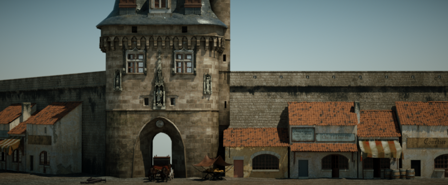

I've gathered my textures to count them and I'm a bit surprised : I have only 41 JPGs and 15 PNGs in my scene + a few more in material macros from the live DB.
Jaberwocky wrote :
I recollect somewhere else in the forum that Radiance said that the maximum texture count in Cuda is 64 different Textures? So if this is still the case then Yes , it looks like your near or over the limit.
But now this limitation compromises a major project for me, on wich I've been working for months and wich is 80% finished. I may have to restart over...or not. So I need facts, I need more than "if it's still the case...". I need to know for sure if whether or not I have to completely change my workflow, if i have to switch to another rendering solution OR simply just change my drivers and Octane version, since they have upgraded to CUDA.4 (wich may imply improvements in terms of performance). That's why I ask Octane developpers, they must know for sure the capabilities and limitations of their software and of the CUDA technology.
