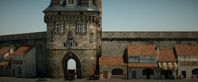

I've gathered my textures to count them and I'm a bit surprised : I have only 41 JPGs and 15 PNGs in my scene + a few more in material macros from the live DB.
Jaberwocky wrote :
I recollect somewhere else in the forum that Radiance said that the maximum texture count in Cuda is 64 different Textures? So if this is still the case then Yes , it looks like your near or over the limit.
Thanks, you're right Jaberwocky, it was there : http://www.refractivesoftware.com/forum ... r+textures :
But now this limitation compromises a major project for me, on wich I've been working for months and wich is 80% finished. I may have to restart over...or not. So I need facts, I need more than "if it's still the case...". I need to know for sure if whether or not I have to completely change my workflow, if i have to switch to another rendering solution OR simply just change my drivers and Octane version, since they have upgraded to CUDA.4 (wich may imply improvements in terms of performance). That's why I ask Octane developpers, they must know for sure the capabilities and limitations of their software and of the CUDA technology.

It's a good idea Jaberwocky, it can be quite useful, i'm dealing with one single animated sequence, but I can split the process in two parts, in term of foreground and background.
There 'll be a slow pan, going down along the town gate, and then I'll zoom-in and focus on one of the little shops that you can see in the picture attached.
In the background, I'll add the inner city buildings (not modeled yet), so 'ill set up a rendered layer for the foreground only, stopping at the remparts with png transparency, and then i'll render the background and composite all in after effects later.
It can be very cool to do it this way.
Still i've spent a fair part of the day recomputing my uvws, it wasn't so tedious as I thought it would be..
