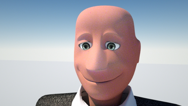

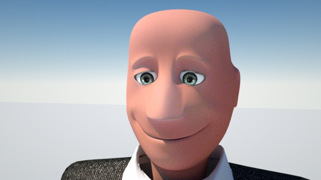

TITAN is giving different render result then GTX690/GTC680 combo.
Second image is TITAN with speckles. How is that possible ? Surface is diffuse with scattering medium.

Can you render the scene with only the 680 (i.e. 1 GPU)? If it renders without speckles I would assume that your hardware has sometimes some calculation errors. But to be 100% sure, could you send us the scene and we give it a shot at the office.BorisGoreta wrote:TITAN is giving different render result then GTX690/GTC680 combo.
Cheers,
Marcus

I know what was the problem, I was testing the image rendered with one TITAN versus the image rendered with the rest of the GPUs ( 2 GTX690 and 1 GTX680 ). So with many GPUs the speckles get averaged out because each GPU produces speckles at different pixels.

With single-GPU setups or if you want to save HDR images, you may want to the hotpixel filter, maybe 70-80% that should get rid of most of the fireflies. Also try out the caustic blur (maybe set at 0.1 - 0.01 depending on the scene).BorisGoreta wrote:I know what was the problem, I was testing the image rendered with one TITAN versus the image rendered with the rest of the GPUs ( 2 GTX690 and 1 GTX680 ). So with many GPUs the speckles get averaged out because each GPU produces speckles at different pixels.
