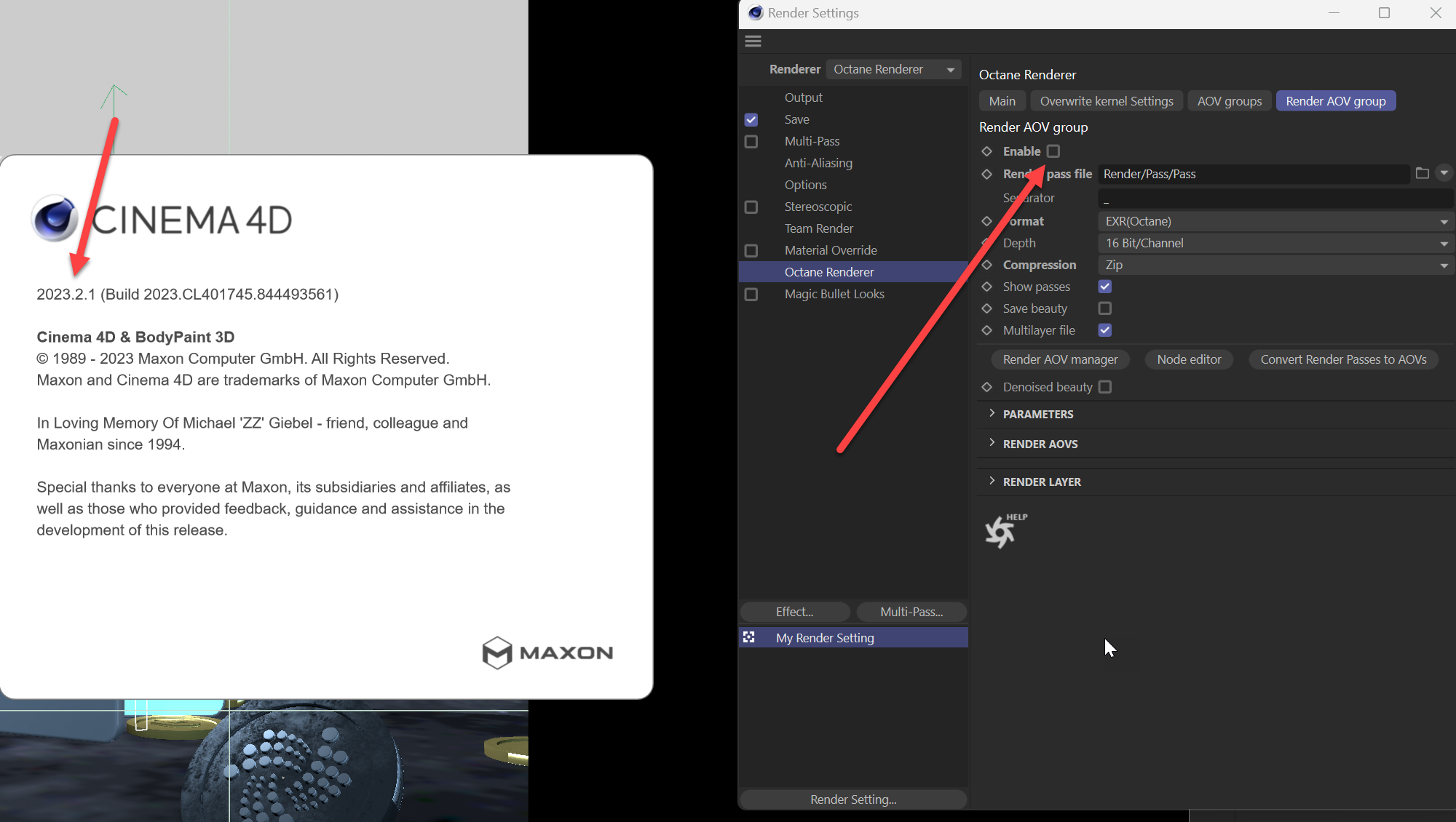

baghbanikm
Posts: 31
Joined: Tue Nov 01, 2016 9:31 am
aoktar wrote:
miohn wrote:
baghbanikm wrote:why in this version , ican't render finally and don't save my Passes in EXR(octane)
always my render stuck in passes render
I have exactly same problem for weeks!
Sometimes it works, sometimes it stucks in "Displaying xxx Pass.
(Win 11, Asus ProArt Z790, 192 GB Ram, 13900K, R 2023 and Octane 2022.1.1 R5)
regards
Mike
It looks like a random problem, but never occured on our systems. My estimation is that about some changes on C4D versions. Which C4D version are you using?
i'm using the 2023.2.1 c4d
now i turn off the Render aov and my render finish correctly .
and yesterday i was test render in low samples ( like 20 samples ) and render is finish correctly
