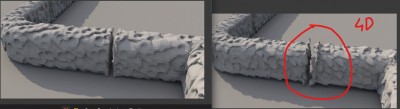

There are stil mismatch between some of the Noise4D noises compared too Noise (OSL ) - for example displaced voronoi octaves doesn't work at all.
Also Noise4D produce strange box projection on edges compared to Noise(OSL) world, object projection while using vertex displacement :

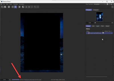

why in this version , ican't render finally and don't save my Passes in EXR(octane)
always my render stuck in passes render

baghbanikm wrote:why in this version , ican't render finally and don't save my Passes in EXR(octane)
always my render stuck in passes render[/size]
Which C4D version?
Activated the any denoise device and denoising in Camera Imager?
I have exactly same problem for weeks!
Sometimes it works, sometimes it stucks in "Displaying xxx Pass". Mostly on denoised passes.
(Win 11, Asus ProArt Z790, 192 GB Ram, 13900K, R 2023 and Octane 2022.1.1 R5)
Sometimes it works, sometimes it stucks in "Displaying xxx Pass.
regards
Mike
It looks like a random problem, but never occured on our systems. My estimation is that about some changes on C4D versions. Which C4D version are you using?

aoktar wrote:
regards
Mike
C4D 2023.2.0
Don't know! But maybe it has to do with the RAM, because I get mostly a bluescreen (kernal secure ...) at first PC start.
After restart everythings seems to be fine except that "displaying xxx pass" problem. But as said it happens randomly here.
regards
Mike
