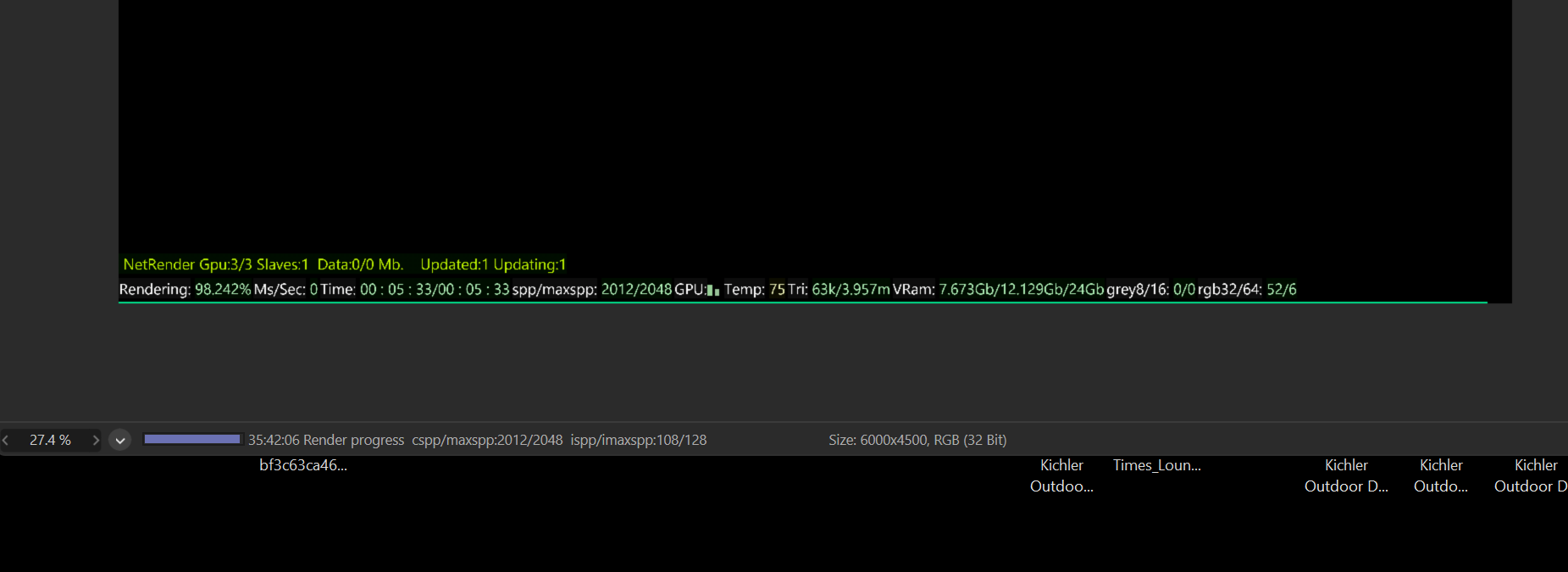

Hi Ahmet,
I have been having issues with the past few releases related to network rendering I believe. My renders will often get stuck at 99% when using a render node attached on a 10gig connection. The timer continues to count, but no samples are finished, and I can hear the GPU's ramp down. Host computer is 2 - 3090, node computer is 3 - 3090.

ndreimi wrote:Hi Ahmet,
same here!

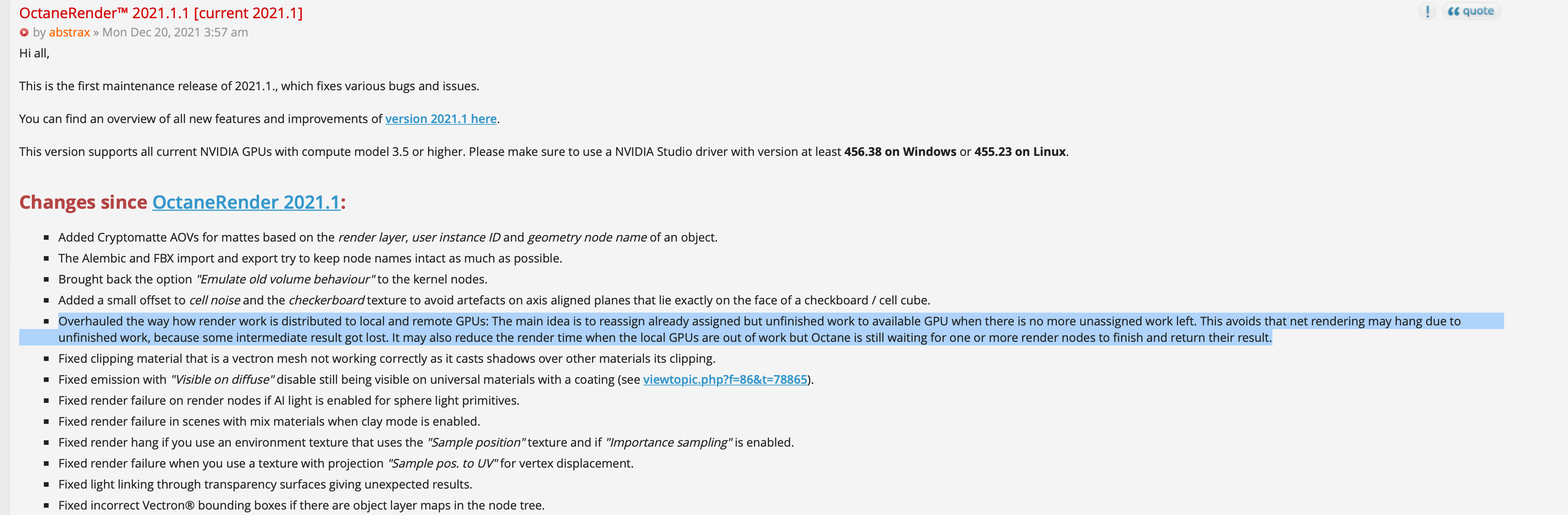

I just saw they pushed out an update, and saw this note. I'm curious if this is the problem we are having.
