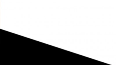

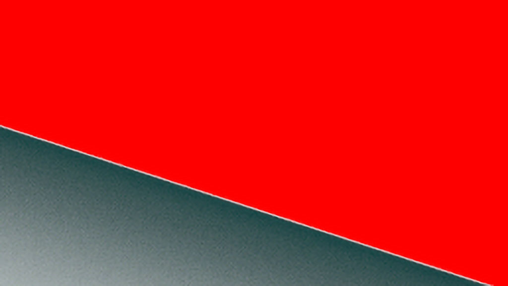

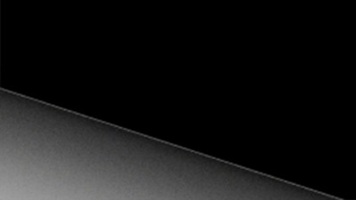

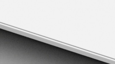

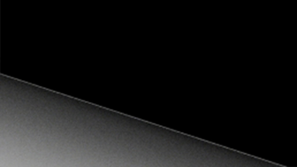

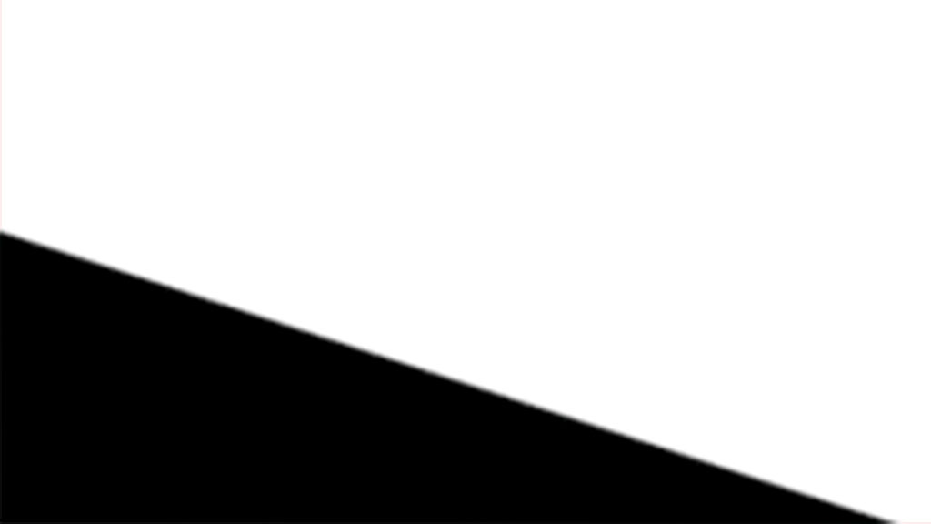

I've come across an issue, where the Object Layer Color and the Shadow Passes don't match.
Here's the combined image I get - see the bright line on the edge of the object? This is the Object Layer Color Pass on its own (the object color is red and with the green and blue channels set to the red channel it comes out white). And this is the Shadow Pass. Now when I use the Object Layer Color Pass to cut out the object from the Shadow Pass, the same line occurs. Ergo, the two passes don't match, by quite a bit. Is this a bug and how can I fix it? Cheers!

Not sure if already asked but please disable denoising for Mat ID passes - it breaks them.

Hi sdanaher,sdanaher wrote:Not sure if already asked but please disable denoising for Mat ID passes - it breaks them.
I didn't use any denoising in this render. Any idea, why this happened anyway?

Hey, I hope nobody minds me bumping this again, but I haven't heard any reply and I'm desperate to solve this. My entire workflow for this project is based on the shadow pass matching all the other passes, that I need to get this fix. Anybody got an idea what could cause this discrepancy between the shadow pass and the object layer color pass? Ahmet maybe? Thanks for letting me know!
Ferdinand13 wrote:I've come across an issue, where the Object Layer Color and the Shadow Passes don't match.
