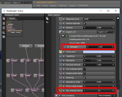

The Lut Strength slider is missing in the plugin.
Also, considering how many HW/Driver issues people are having, I think it would be useful to have the 'Max. tonemap interval' parameter available in the plugin just in case. Just like it is in the Standalone. I also noticed that the default value is different in the plugin than the one in the Standalone. Maybe someone might have to adjust that parameter but it's not available in the plugin.
Regards
Milan

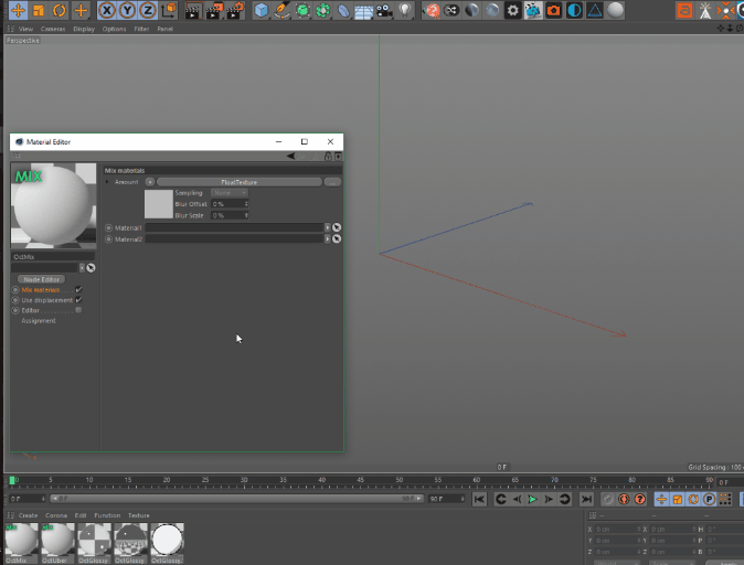

I'm still finding inconsitency issues among the shaders preview windows resizing: they behave differently along MIX, Uber, Metal, Diffuse, Toon, etc. concerning pixelation, sphere framing, stretching, sometimes is pixelated, sometimes are ok... I found the MIX material to be the only to nicely previewed in every aspect mentioned.... the others beahave randomly well...
I'm uploading this small .gif, perhaps it may help improving this, Aoktar!
Cheers!

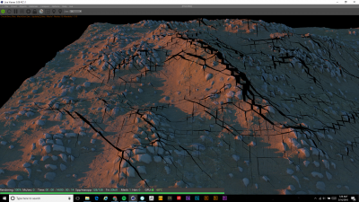

It seems that the latest update has some issues with phong angles and displacements maybe? The textures work on flat planes, but when I create a landscape object and apply the texture I get the outcome in the attached screenshot. I am using a material that I've used many times in the past. Attached is a screen shot of the outcome on the newest 3.08-RC1.1 version.
I'm sure you probably have already had people report this, but wanted to put it out there as well.
Thanks for all you do Aoktar!
- Stuz0r
