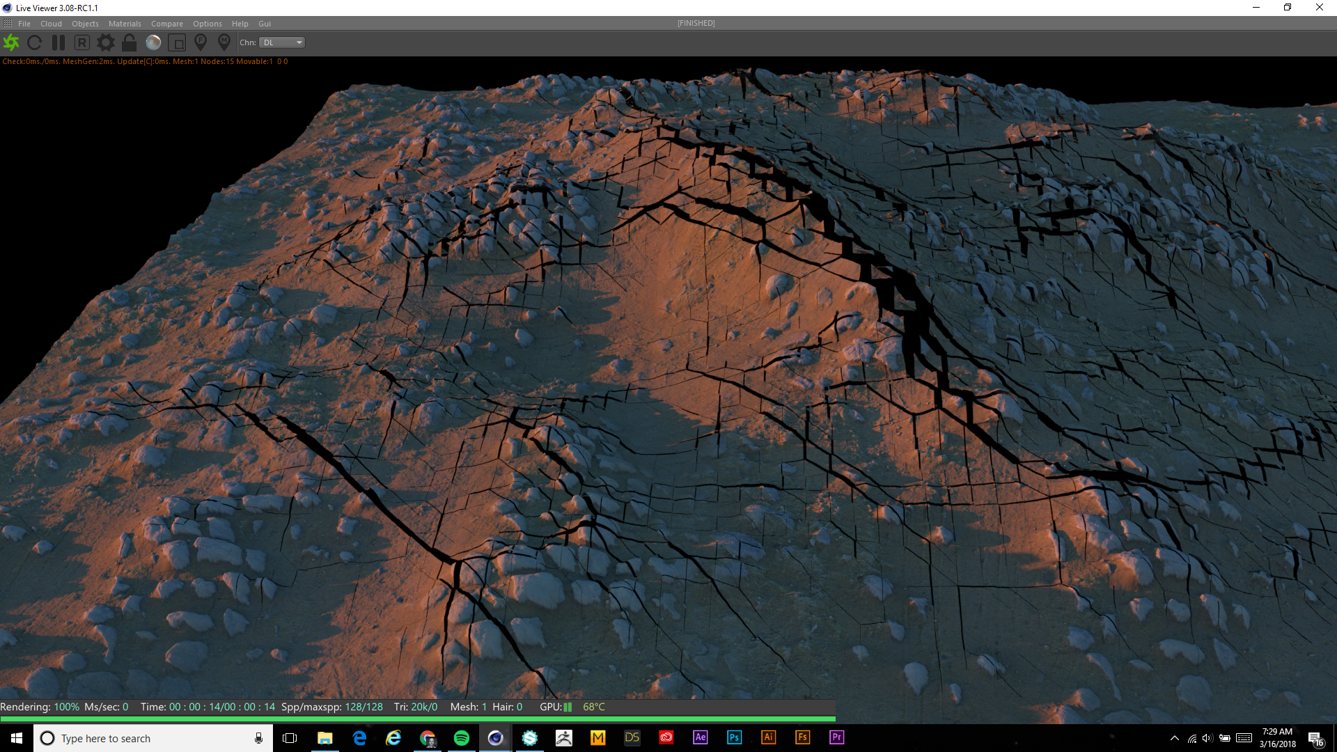

It seems that the latest update has some issues with phong angles and displacements maybe? The textures work on flat planes, but when I create a landscape object and apply the texture I get the outcome in the attached screenshot. I am using a material that I've used many times in the past. Attached is a screen shot of the outcome on the newest 3.08-RC1.1 version.
I'm sure you probably have already had people report this, but wanted to put it out there as well.
Thanks for all you do Aoktar!
- Stuz0r
- Stuz0r
