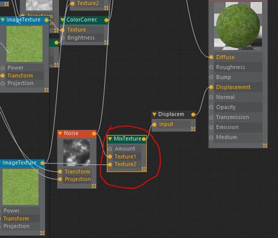

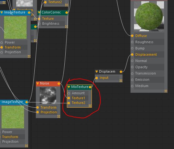

Good day aoktar.
Q1
Can you please check the linkage in saved materials. If I save my material which have displacement into localDB it not save Displacement and leave it empty.
Same with LiveDB - by thumbnail I can see that material have Displacement but after downloading it again it is empty.
Q2
Is it possible add into Node Editor option Save Material in orbx?
Q3
Is this correct that mix or multiply not working as Displacement map..only image?
Posts: 16068
Location: Türkiye

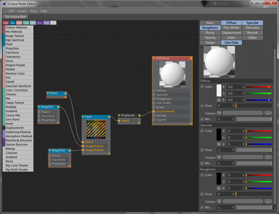

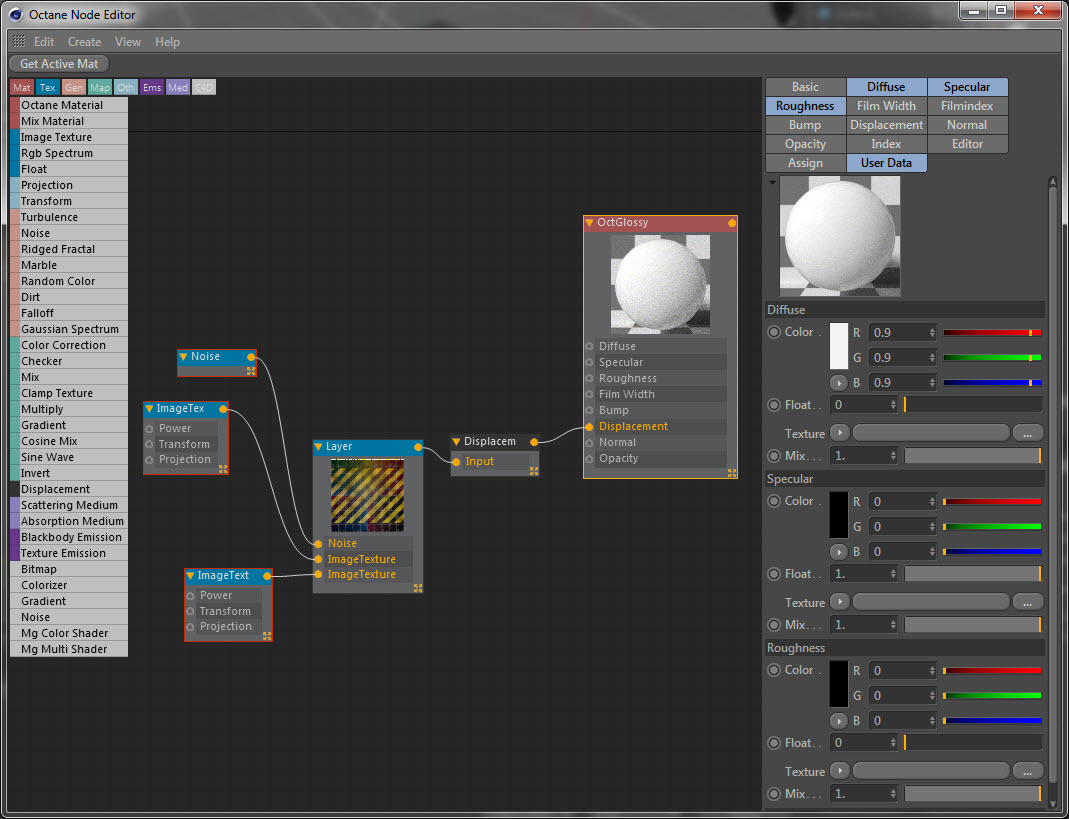

Hi Valters,
Displacement don't accept any texture type except imagetexture. So saving problem is normal. It will ignore when you connect mixtexture. Also same for rendering. There is a work-around for this. See my setup.
Adding a save orbx command is not so easy from Node Editor. Alternatively you can use LiveDb window. You can drop your material to localdb and explore the saved orbx.
