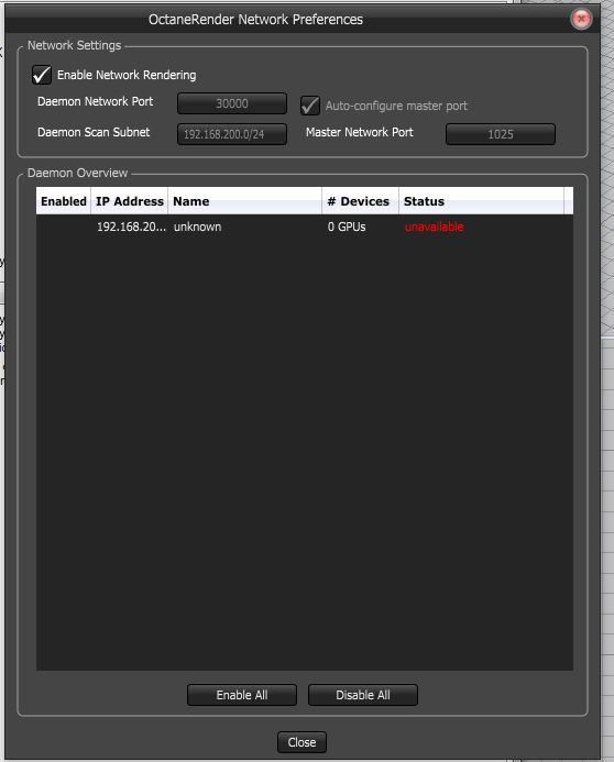

Hello Paul,
I have a quick question:
I am trying network rendering but it does not seem to work (please see pic)...
the network monitor shows the slave as unavailable, is it possible that build 2.16 (Rhino) does not like to play with 2.20 (octane standalone)
thanks
Andreas
Hi Andreas - as per the "Slave" version info at the start of this thread - you need to use 2.16 slave with the plugin release 2.16.0.*.

Network Rendering
For Network Rendering, you must use the Octane slave release 2.16 available from the Development Build Releases subforum.
sorry, I overread it :oops:
