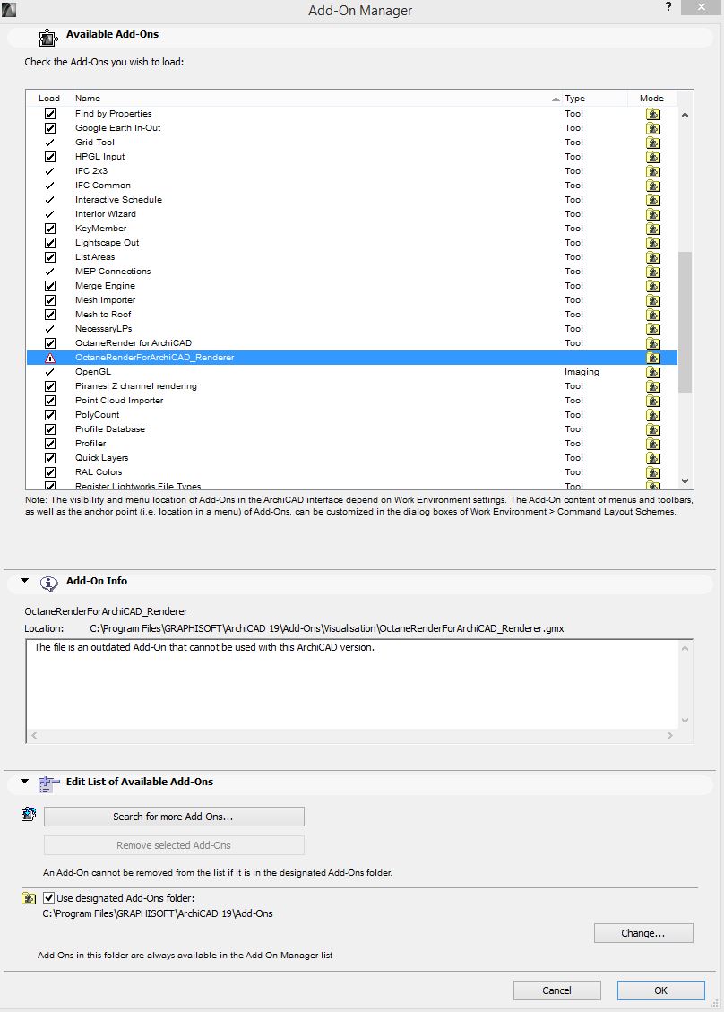

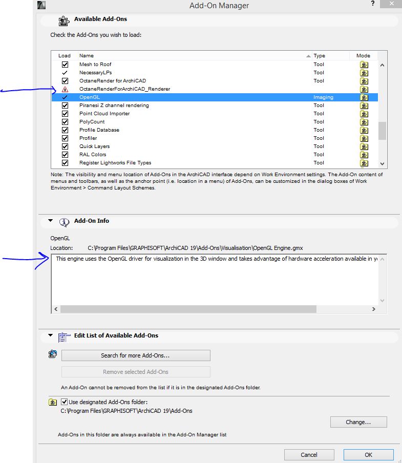

Hi Paul,
Just got into installing Archicad 19 and also the plugin.
The plugin works fine, but I noticed the add-on notification?

face_off
Posts: 15755
Location: Adelaide, Australia
Hi Jeroen - that is the status text for the OpenGL addon, not the Octane addon. If you select the OctaneRenderForArchiCAD_Renderer addon, what text is displayed pls?

rappet
Posts: 1962
Joined: Fri Apr 06, 2012 3:57 pm
Location: The Netherlands
face_off wrote:Hi Jeroen - that is the status text for the OpenGL addon, not the Octane addon. If you select the OctaneRenderForArchiCAD_Renderer addon, what text is displayed pls?
Paul
Oops, brainfailure :oops:

Thanks Jeroen. What build of AC19 are you using pls? Is it possible you installed the AC18 version of the plugin into AC19? If so, you need to install the AC19 version.
Paul

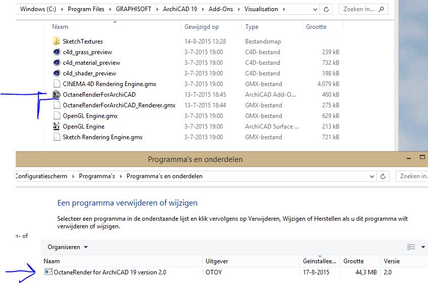

I am almost sure I did install the Ac19 version...
I will check (also build) (my) tomorrow :-)

face_off
Posts: 15755
Also, make sure your plugins are being loaded from the AC19 folder.
Paul

Hi Paul,
Checked, even reinstalled, but the same.
(The plugin works though)
