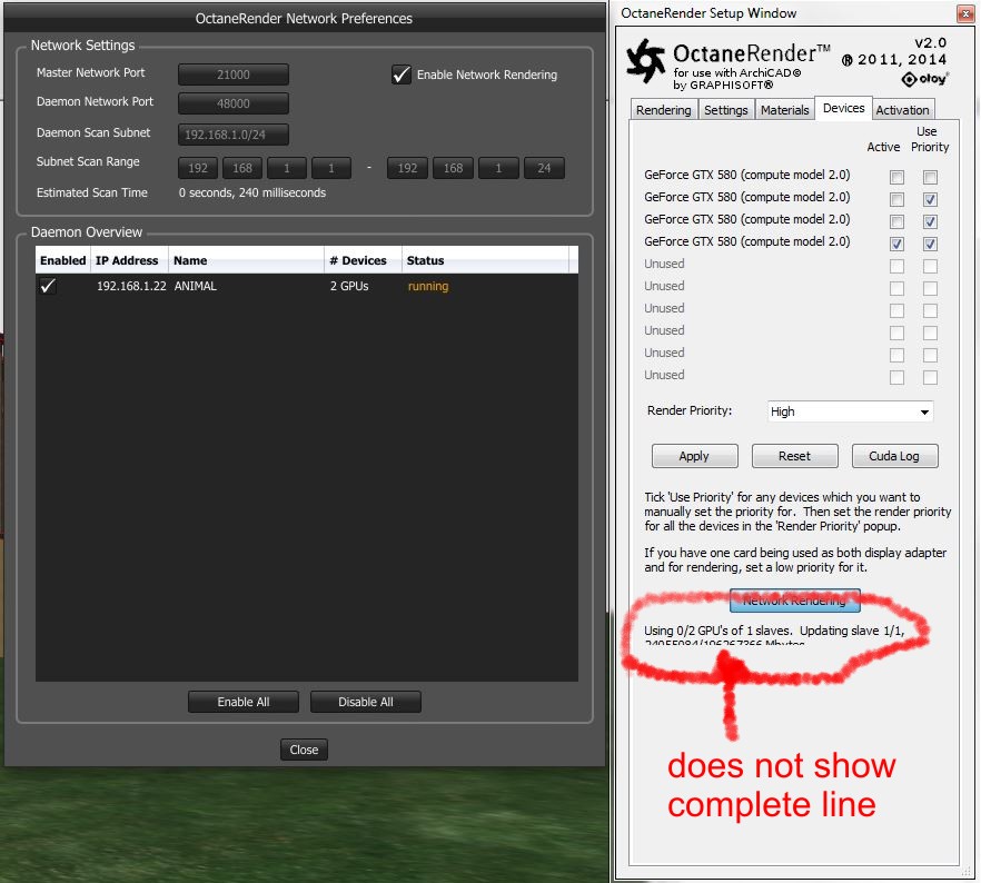

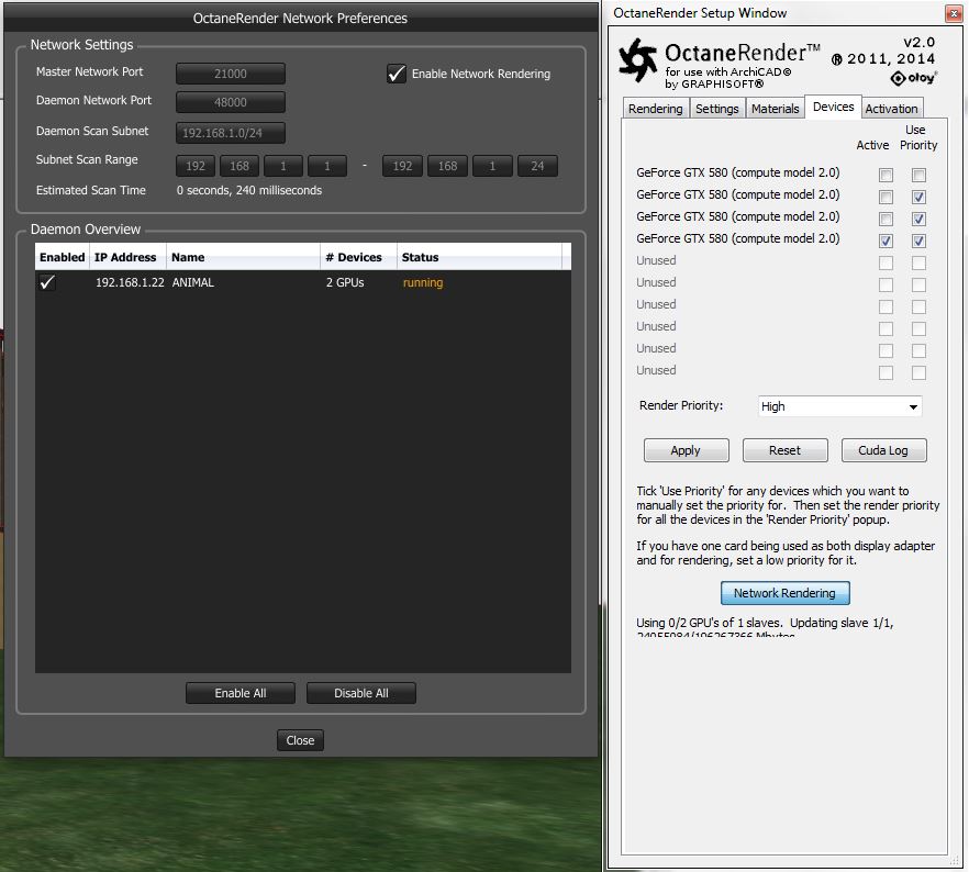

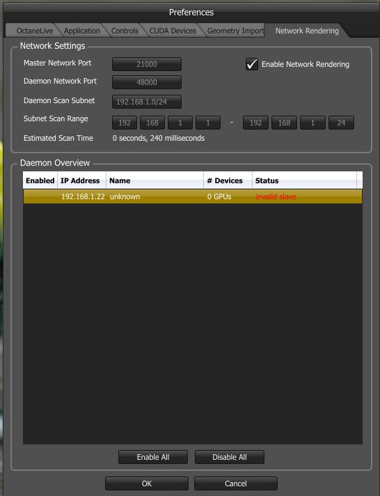

Hi Paul,
I am trying to run network rendering with two Titans on a slave.
Something is going wrong, but I cannot get m finger on it.
When I open the OctaneRender Network Preferences fromout the plugin it look slike the 2 devices are running, but the Octane Render SetupWindow syas it is using 0/2 GPU. Adn when looking at the renderspeed, the slave does not speed up, so they are not working.

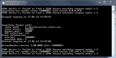

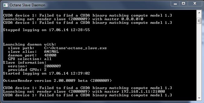

On the slave I got this error, but that m ght be due o the fact that the slave has also a gtx275 that is not supporte, but the two Titans should/could be running?
I do not know where to start to solve this. Do you have any idea?
EDITED:
At the same time I opened the Standalone and it showed this:
greetings, Jeroen

abstrax
Posts: 5516
Try installing the latest CUDA driver on the slave.

abstrax wrote:Try installing the latest CUDA driver on the slave.
Hi Abstrax,
Thanx for your quick response.
I am downloading the cuda 6.0.37 and will get back here with result.

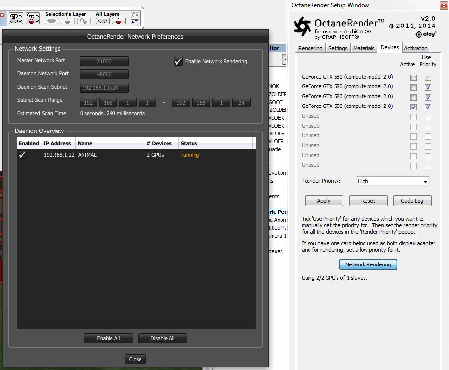

I have updated the cuda on the slave, but I do not think that might have solved it.
The strange thing happened that I got it working for one time... the slave had two gpu rendering (I checked the renderspeed too), but when disabling and enabling I do not get it back.
Strange?
But I got it working one time, so that is hopeful.

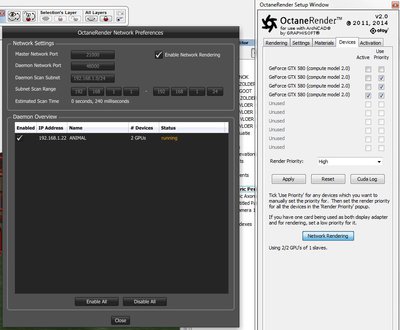

Greetz,
EDITED:
I Just posted and clicked one tipme on the OctaneRender Setup Window and I see that the 2 gpu are running again!!!
I gotta try and figure this out, when "yes, it runs", and when "no"

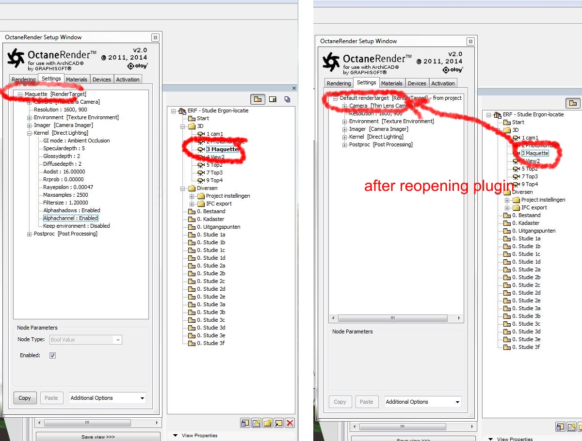

The plugin does not seem to remember the save rendertarget to view?
greetz, Jeroen

OK, I figured it out.. ofcourse something I overlooked :oops:
I probably got internet connecton problems while the slave is loading the scene and my network is overload to have an internet connection as well.
Can this be?
@Paul, The thing is.. I missepld the loading part while I could not see clearly that the slave is loading.

face_off
Posts: 15819
Location: Adelaide, Australia
I just checked this and it was working OK for me. Are you just shutting closing and then opening the plugin, or shutting down ArchiCAD?
Fixed in the next release.
