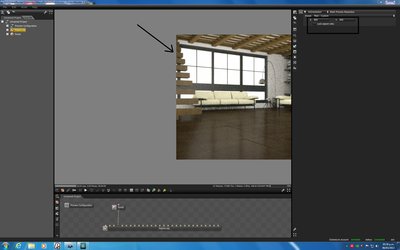

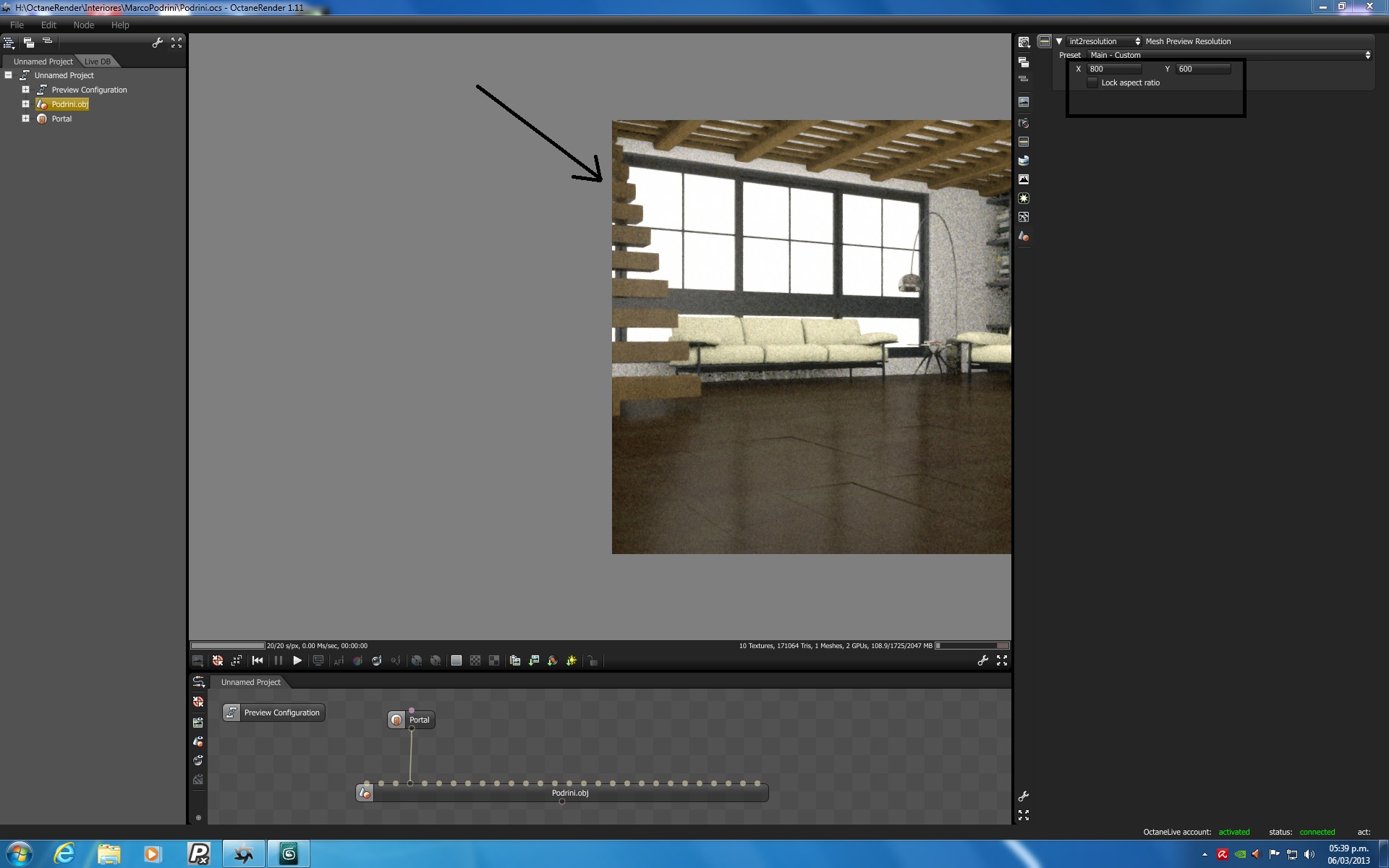

Merid, this seems to be normal, happens to me too.merid888 wrote:hi abstrax i have a problem, when i change the resolution appear the image like the screen, maybe is a bug ? do this in any size
thank you, hope you can help me, i need close and restar the octanerender standalone again
When you have a high resolution and you move the image with the sliders right and bottom (not the camera but the image) and then go back to a smaller resolution the image stays where it last was.
Simple solution: There is a small icon bottom left under the viewport, two red circles with two white arrows, 'Center Image' or something like this.
It does exactly this, centers the image in the viewport!
Hope this helps, even if it seems to be in the wrong thread...
