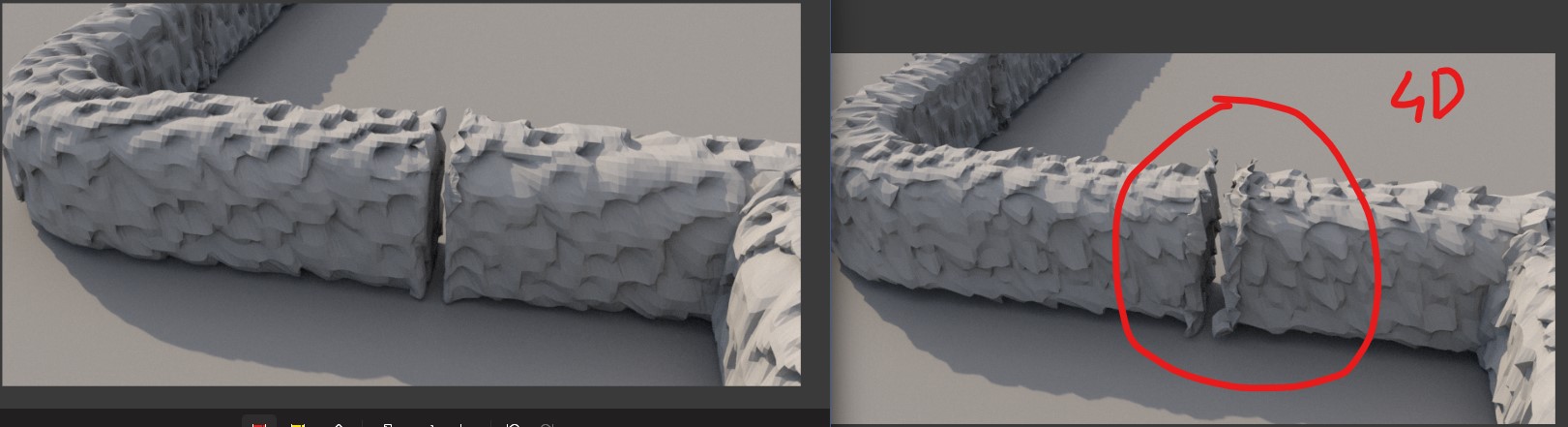

There are stil mismatch between some of the Noise4D noises compared too Noise (OSL ) - for example displaced voronoi octaves doesn't work at all.
Also Noise4D produce strange box projection on edges compared to Noise(OSL) world, object projection while using vertex displacement :
