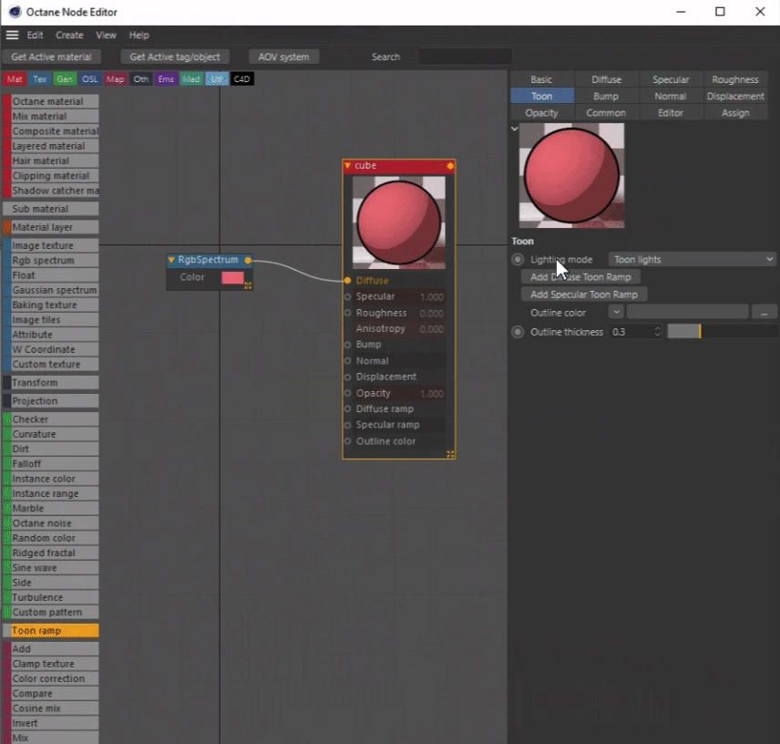

Hey aoktar,
It seems that the only way to add a Diffuse/Specular Toon Ramp is from the buttons in the Toon tab for a Toon material. If you try to connect the nodes manually, they won't connect.
(Animated GIF attached)
