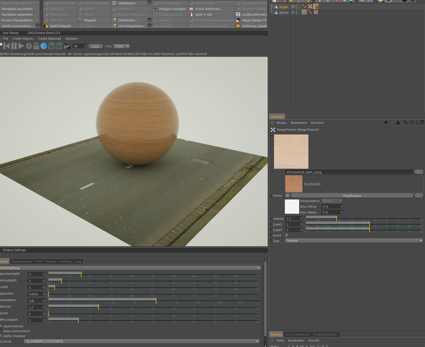

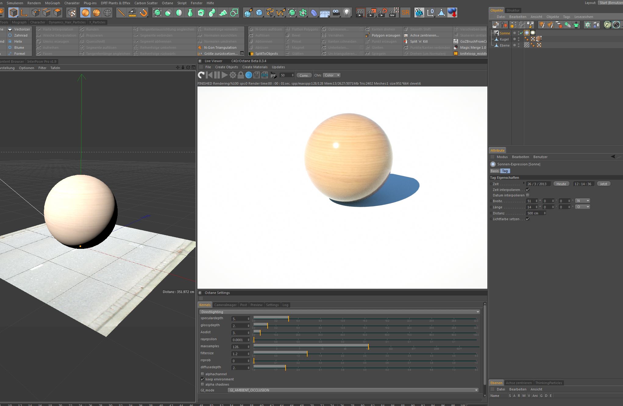

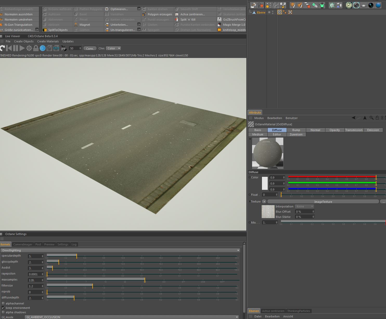

Hi aoktar,
here are some screens.
In this case I first added a plane and a diffuse mat with a road-bitmap (tex_1).
Second I added a sphere (converted) with a wood texture in the imagetexture channel (tex_2).
Third I added a C4D sun and a OctaneLight tag.
Now the ground texture disappeared (tex_4)
I'm going crazy because of this!
Does others have this problem too?
thanks
Mike
Posts: 16068
Location: Türkiye
for last picture, there is only a object in Object Manager. where is ball and sun? Also OctaneLight Tag is works arealights only. For sun you have to put DayLight Tag.
