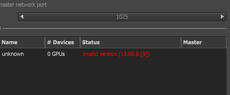

Hi there. I actually already had this version installed, but just to be safe, I uninstalled, redownloaded and reinstalled, and I'm still getting the same error (attached).
I am running the latest stable version of Octane within Cinema 4D 2024.1.0. Any ideas on why I keep getting this Network Render error?
Thanks - Joel

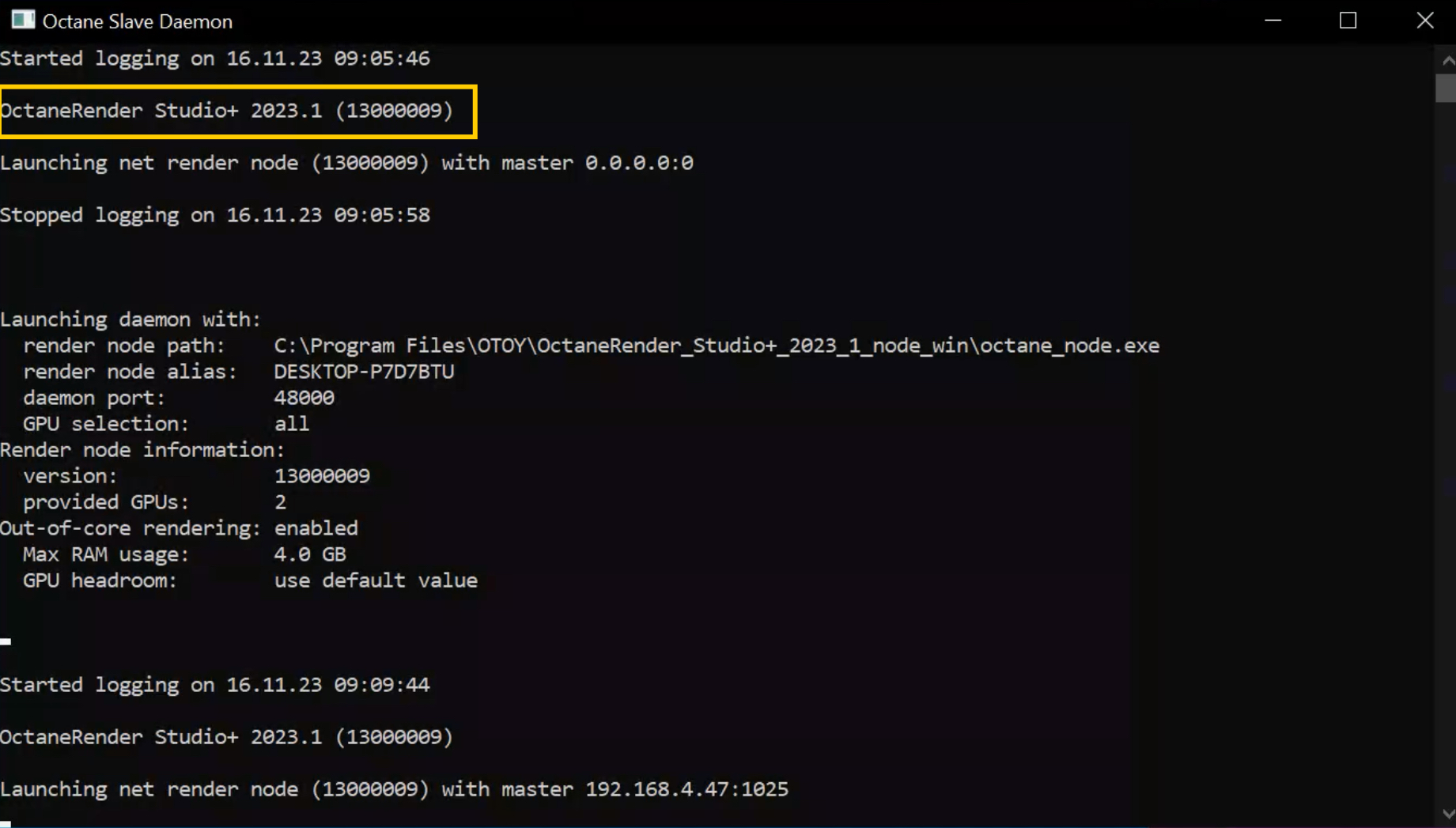

Hi Joel,
the daemon version is correct:
Please go to c4d menu Extensions/Console, (Shift+F10), and share a complete screenshot of the panel, or copy paste the default console output in your answer, thanks.

Well it turns out it was user error....I had updated Octane on my main machine within the wrong version of C4D without realizing it. Now that I have the latest Octane build in C4D 2024, it's working flawlessly. Thanks for the help!

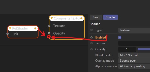

It would be great to have "Enable" input for composition texture layer to make it useable for programming switching and for RefShader node like this :
These nodes have very aggressive bright node color.

SSmolak wrote:It would be great to have "Enable" input for composition texture layer to make it useable for programming switching and for RefShader node like this :
Enable linked to dsiable mode of nodes
