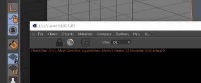

For me in R20, NVidia 419.35 not drawing the full UI:
Posts: 16068
Location: Türkiye
lancemoody wrote:
Try with older Driver or plugin.

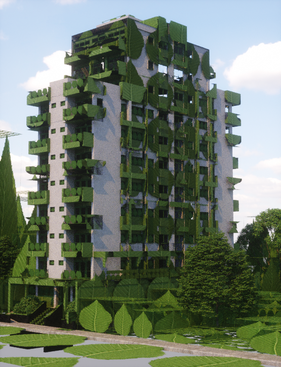

adamfilip wrote:with R4 im finding its breaking and switching texture links.. I had to revert back to R3
So i apply one texture and another shows up
Same happening to me in R18 and V4 R5.
Leaf shader in place of the concrete shader... very weird.
This is showing in Live viewer window... in object manager the shaders are correctly assigned.
EDIT: I reverted to V4 R3 and problem is fixed.
Could you please mind a sample scene with me?
