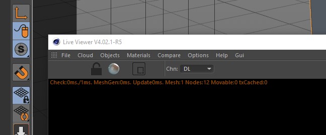

For me in R20, NVidia 419.35 not drawing the full UI:

lancemoody wrote:
Try with older Driver or plugin.
