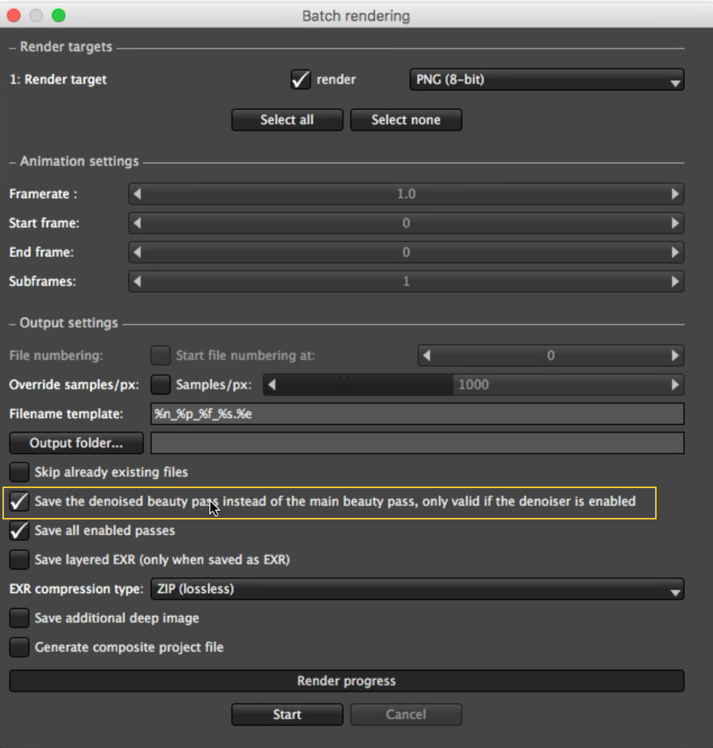

Hi Where is this option "save the denoised beauty instead of the main beauty pass" in cotane 4 XB3? I looked everywhere ThanksNotiusweb wrote:No...Ugh!vijay_thirukonda wrote:Did you enable "save the denoised beauty instead of the main beauty pass" checkbox? Just tested it, seems working as expected.Notiusweb wrote:I just exported a 720 frame sequence through Batch Render with Denoiser on, and as the process ran each frame appeared in the viewport as being denoised.
But here is the beautiful part - the saved images were not denoised at all.
Full noise.
AWESOME![]()
It's right there....I guess in the case of the Batch-Render script, it needs that separate instruction...
Sun of a Beach.....
Hi coilbook,
run the Batch rendering script, the option is in the panel settings of the script: ciao Beppe
