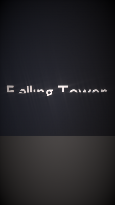

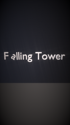

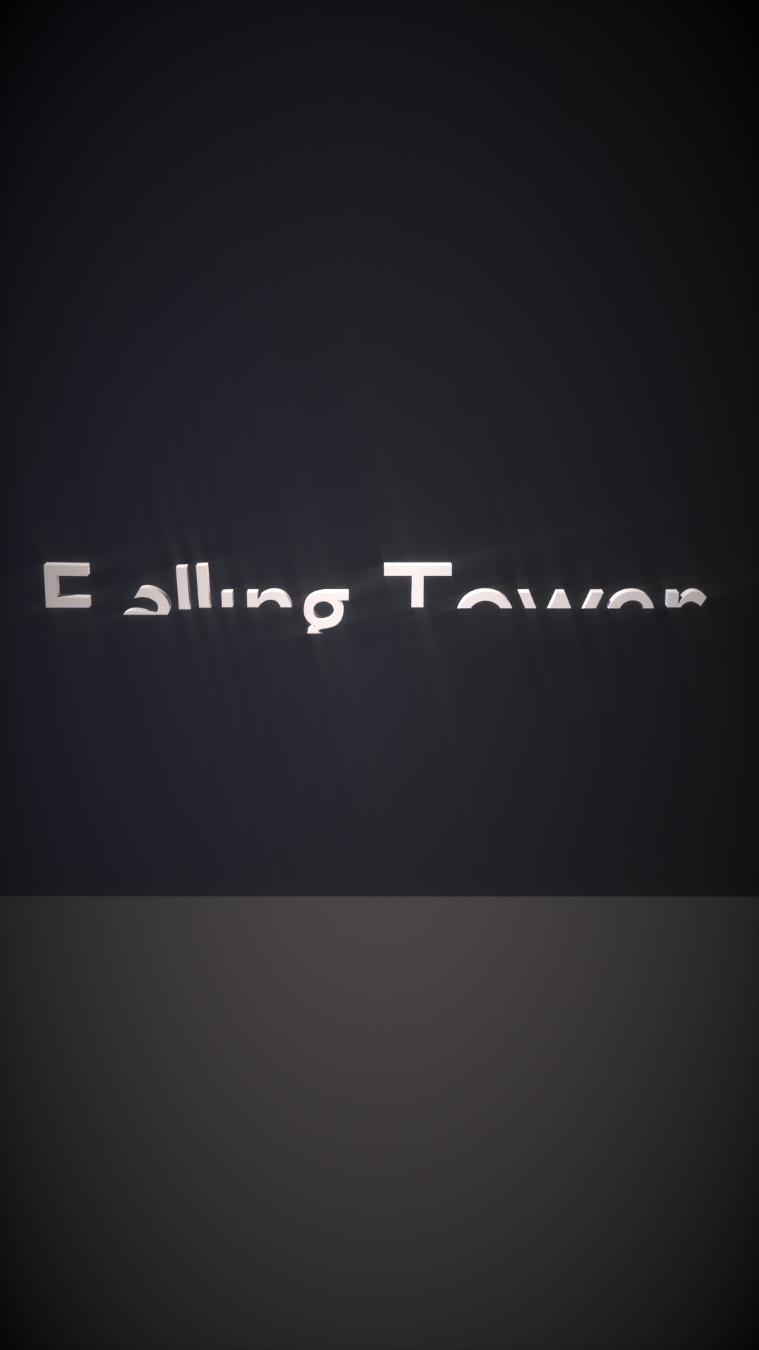

I made a very simple animation in blender. I've exported the file in orbx format. Octane 4, while rendering in batch mode, trims a piece of model geometry.
For comparison, I put the same frame rendered in Octane 4 and Octane 3.
This happens only in batch mode. When a single, static frame is rendered, everything is ok.
By the way: Octane 3 is a bit faster :) colors are also slightly different
Because the file is very small, I attach it.
M.
cam.orbx
ORBX animation file
(4.04 MiB) Downloaded 346 times
Octane 3 batch mode
Octane 3 batch mode
Octane 4 batch mode
Octane 4 batch mode
Octane 4 sigle frame

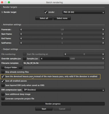

Notiusweb wrote:
vijay_thirukonda wrote:
Notiusweb wrote:I just exported a 720 frame sequence through Batch Render with Denoiser on, and as the process ran each frame appeared in the viewport as being denoised.
But here is the beautiful part - the saved images were not denoised at all.
Full noise.
AWESOME :|
Did you enable "save the denoised beauty instead of the main beauty pass" checkbox? Just tested it, seems working as expected.
No...Ugh! :oops:
It's right there....I guess in the case of the Batch-Render script, it needs that separate instruction...
Sun of a Beach..... :x
Hi Where is this option "save the denoised beauty instead of the main beauty pass" in cotane 4 XB3? I looked everywhere Thanks
Posts: 10632
Hi coilbook,
run the Batch rendering script, the option is in the panel settings of the script:
ciao Beppe
coilbook
Posts: 3175
bepeg4d wrote:Hi coilbook,
The attachment 6162F958-C5D2-44AE-910C-145DAE00980D.jpeg is no longer available
ciao Beppe

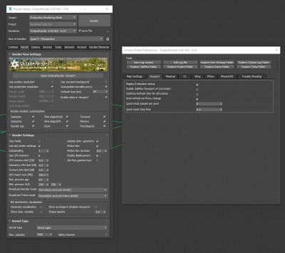

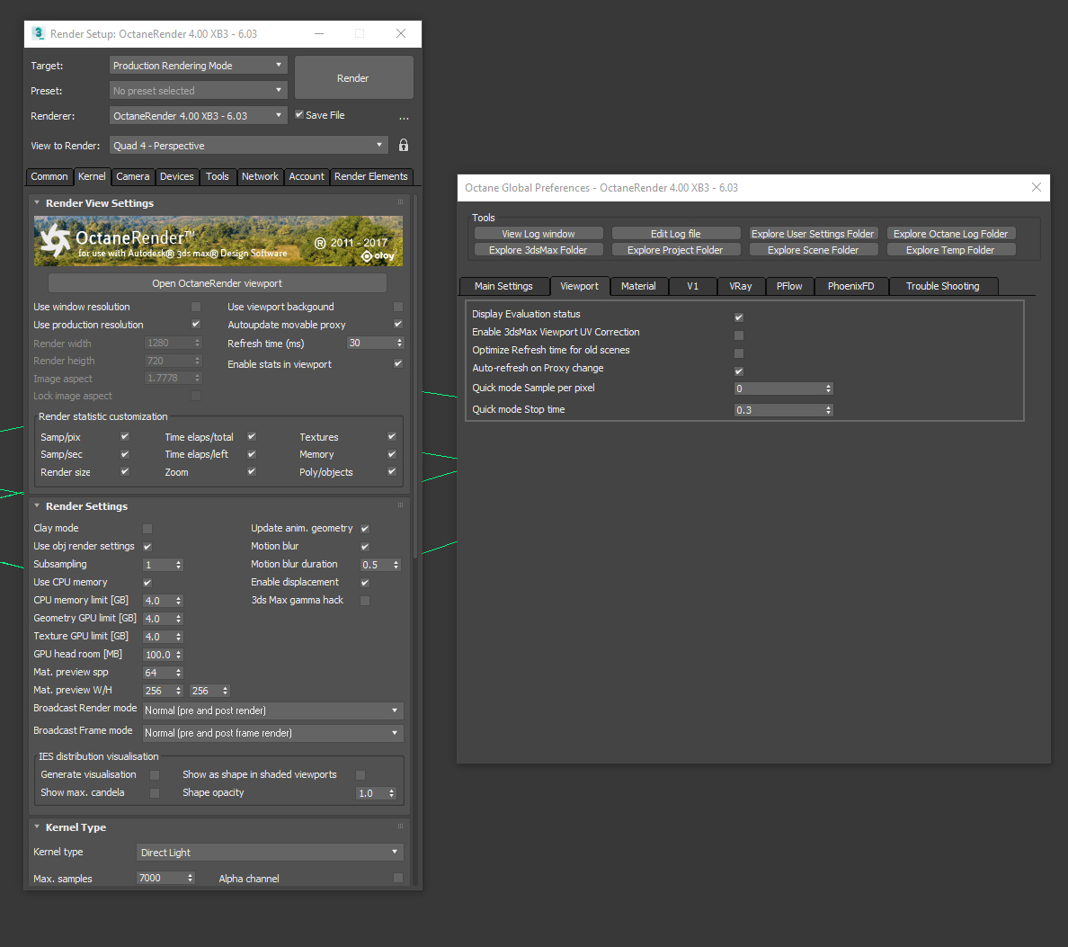

HI Beppe,
could you tell me where exactly should I go to find it?
is it a separate script ?
Thank you
Posts: 10632
Hi coilbook,
this is the Standalone/SDK section of the forum.
Please, ask about 3ds Max specific options in the proper Otoy forum section, thanks:
viewforum.php?f=27
