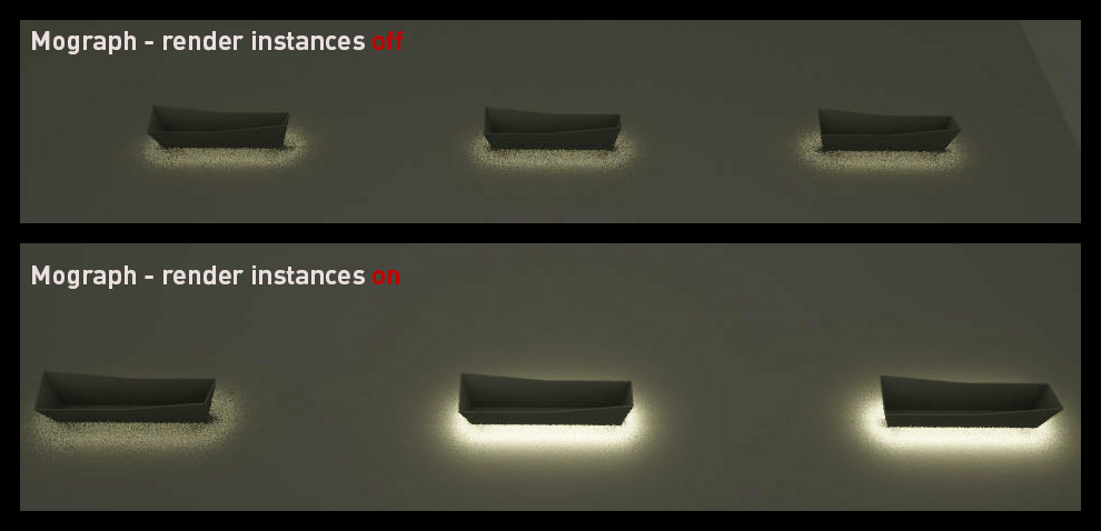

I've just noticed something weird. i a have an object which has emmison polygones. i used mograph to duplicate. see what happens with/without checking "render instances"

sadece wrote:I've just noticed something weird. i a have an object which has emmison polygones. i used mograph to duplicate. see what happens with/without checking "render instances"
when you don`t use object tag, all objects will be collected a single mesh. but object tag exports all as individual meshes. but situation is different o render instances. they are always exported as individual meshes.
so what's the relationship for your problem?
emissions seems different due polygon area. on your first images, 3 objects are a part of big single mesh. check octane node graph to see what happens actually

Btw is it right behavior for the emmision materials are related to size of objects? Same emission material on a huge sphere and a tiny one, should the brightness be same ?

sadece wrote: Thanks for the info.
i think so. Seems like that reflects same amount of illumination without accounting size. this explains why collected meshes don't casts the illumination for each boxes as a indivual mesh.
