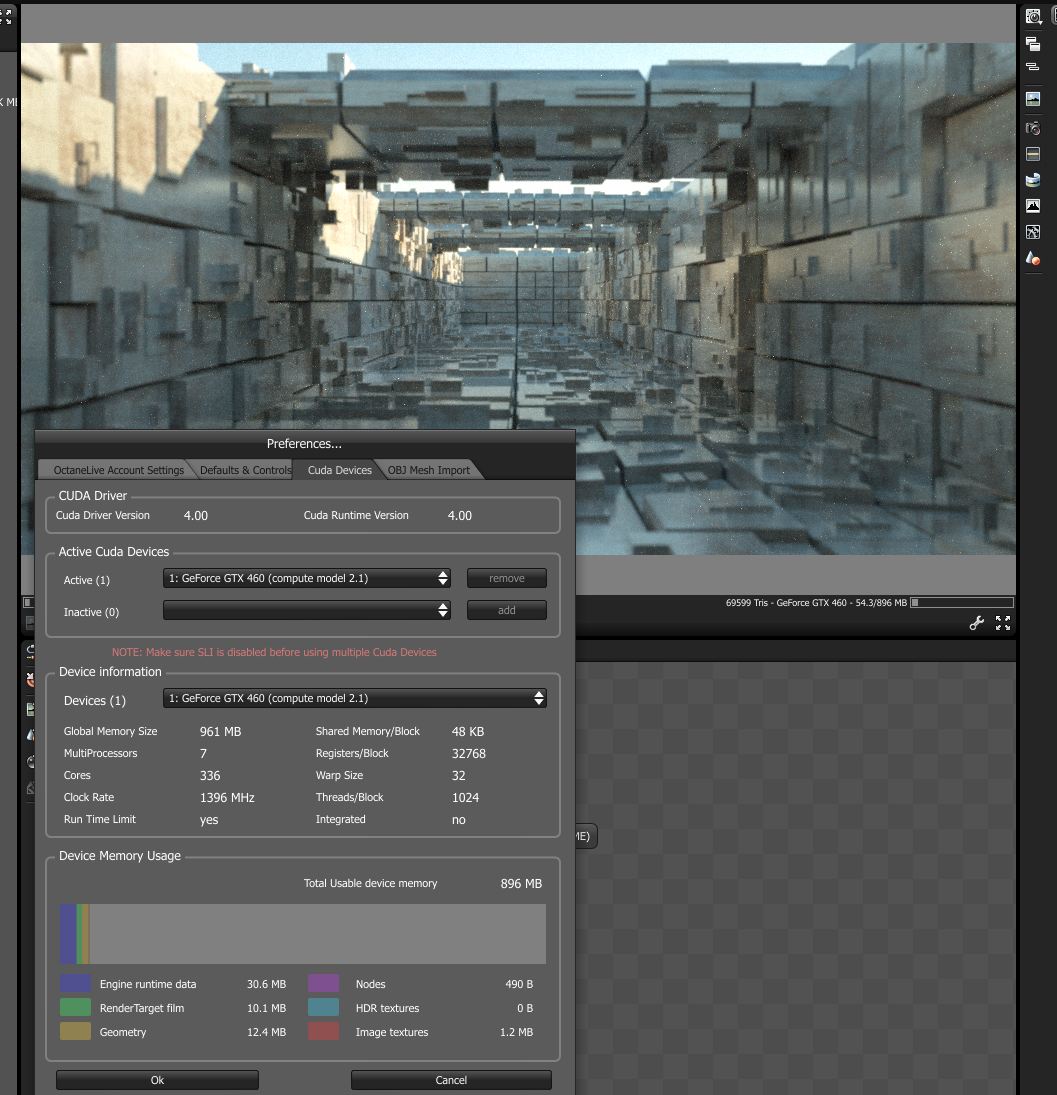

I think I've found you a couple more problems.
Check out the images attached.
I decided it was high time to rake out my old ATI XT2600HD - 256MB graphics card and put it in the case as my display card.Then run the GTX460 1GB card Headless.
Everything works perfectly except.
1) I'm only seeing 896Mb of memory available rather than 1GB that i expected.
2) The Trench scene and others seem to throw a fit when you try to render them at high res.
Other than that i can do other work fluidly whilst Octane runs in the background.

To 1): I don't know where the memory is going, but you never get the full memory that should be available. I guess either CUDA or something else has some overhead, but I really don't know.
To 2): At which resolutions do you get this problem?
Cheers,
Marcus

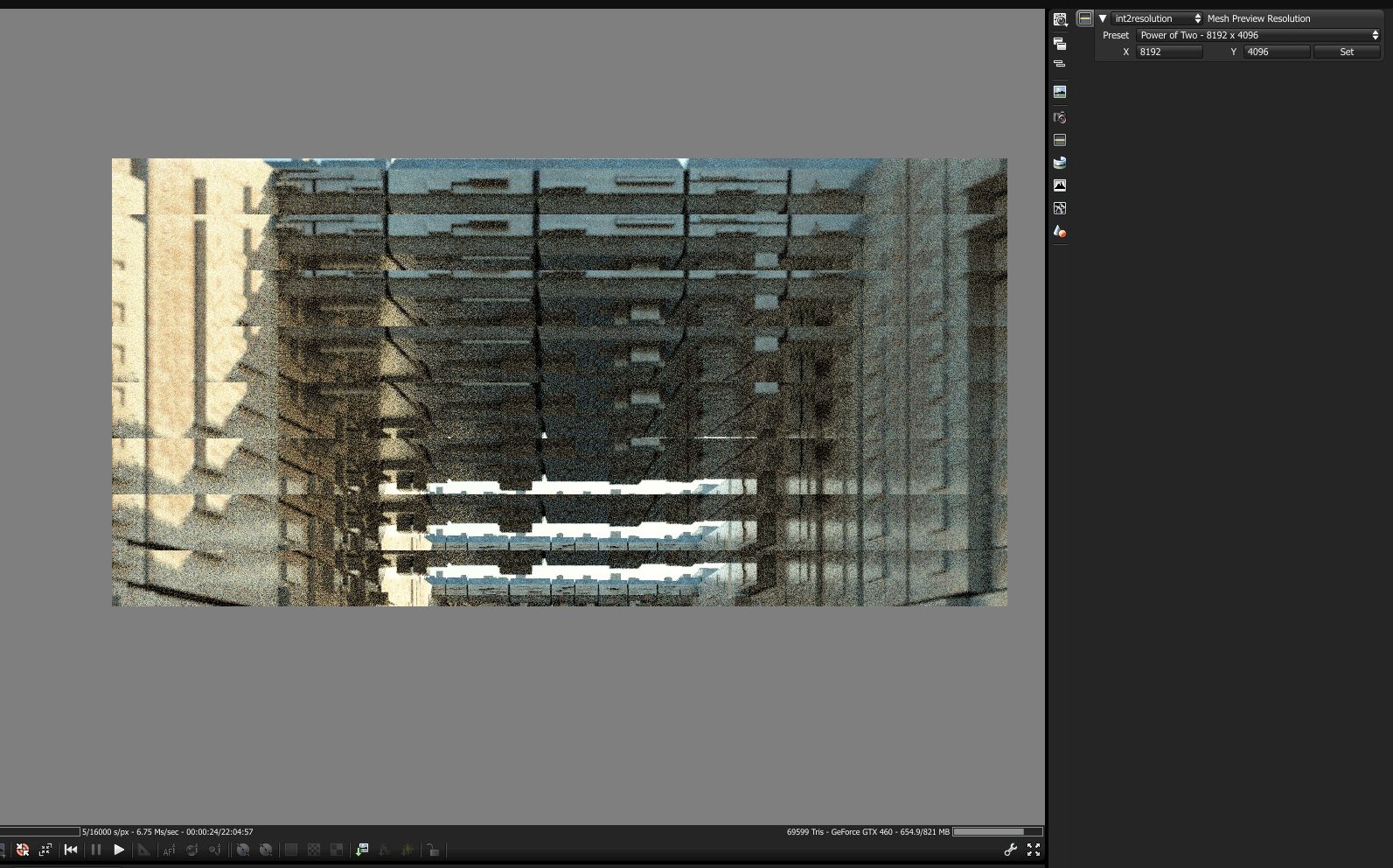

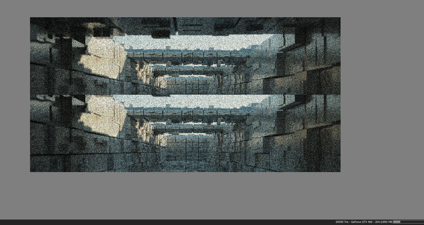

I've ran some tests. As you can see from the various images. The picture seems to keep splitting (a bit like an amoeba ;) ) at increases in resolution
Using the camera Pre sets it's as follows:
A single image is visible up to the 2464 x 1648 camera Pre set
A dual image is visible up to the 3520 x 2344 camera Pre set
After that it is a 3 way split all the way up to the 4032 x 3024 camera pre set.
I then tried it on the maximum power of 2 setting of 8192 x 4096
and got this....... It's an 8 way horizontal split picture !!
Hope this helps.
